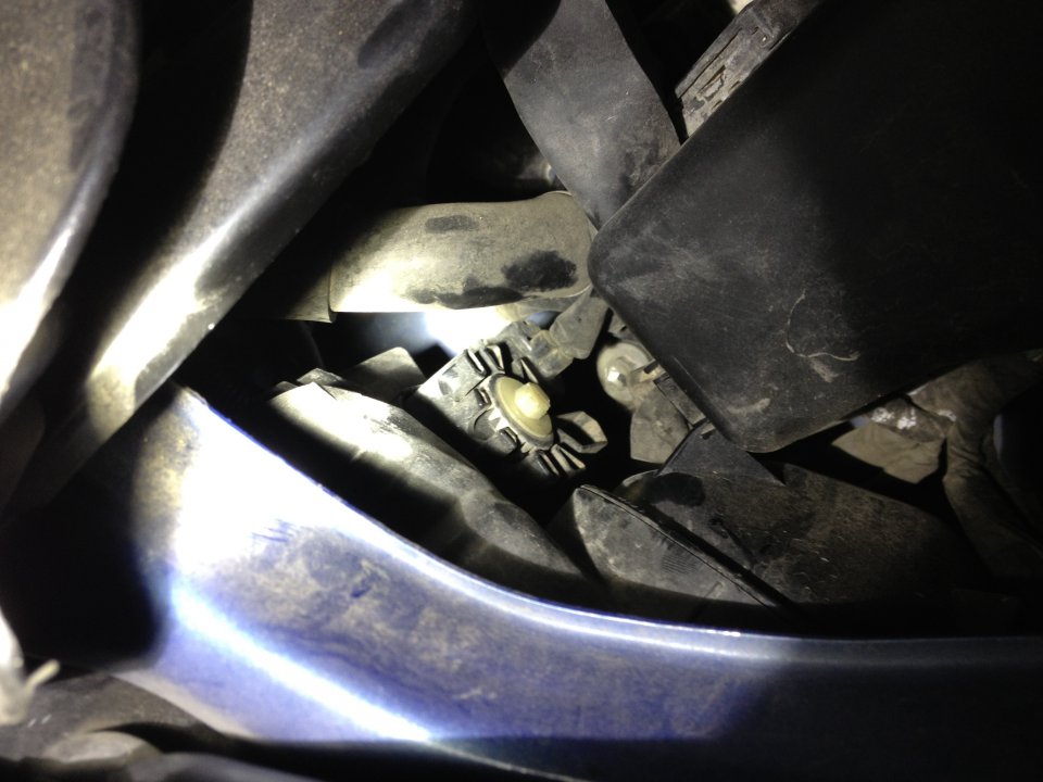

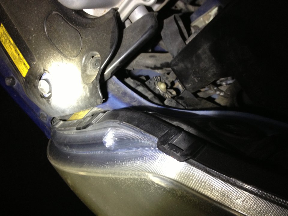

    Mine was aiming too high too after I changed both headlights ...It's late now but tomorrow I will open the hood and find that famous "adjuster" that everybody is talking...do you have a pic of this adjuster or where to find it?

    First picture is the zoomed in picture of the plastic bolt.
    Second gives you some context. This was taken on the driver side. I am standing behind the headlight, closer to the side mirror.
    The passenger side bolt is more difficult to get to as its blocked by some type of hard plastic stuff.
    Edit: My Prius is 2006 w/ HID Headlights
