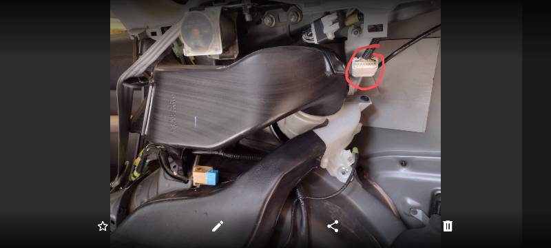

    Code P0A84 is the one that needs to be fixed. Check for corrosion in the electrical connector for the hybrid battery cooling fan. This is a very common problem for a Gen 2 Prius.

    Specifically, there's a white connector behind the right side interior body panels near the battery fan. It's not uncommon to have a body leak allow water to dribble into that connector and corrode it.
    The repair is to hard splice each wire, eliminating the connector. Then clean and reseal the cracked body sealant around the tailgate hatch frame.

    @Brian1954 and @mr_guy_mann are correct. It was a burnt out connector caused by corrosion from the body leak.
    The garage’s immediate reaction was that I had to replace the hybrid battery. The mechanic sounded *so happy* on the phone when he told me it was just a burnt out connector.
