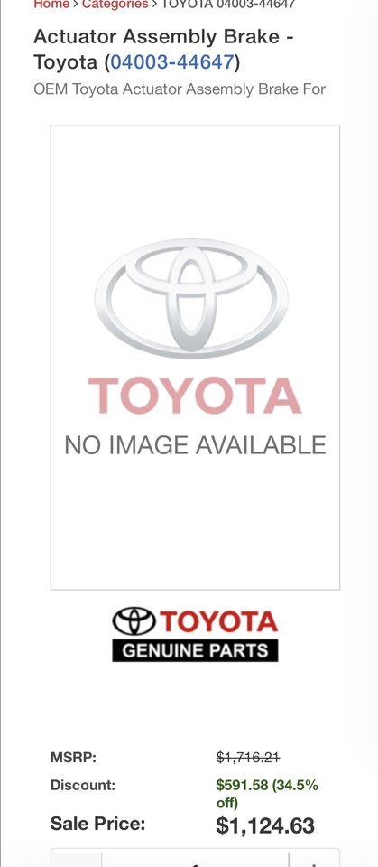

    How are you paying $3500, and what is this 'manifold' you speak of?

    From link above. Some dealers may have free shipping as well.

  17. Classic Car Guy
