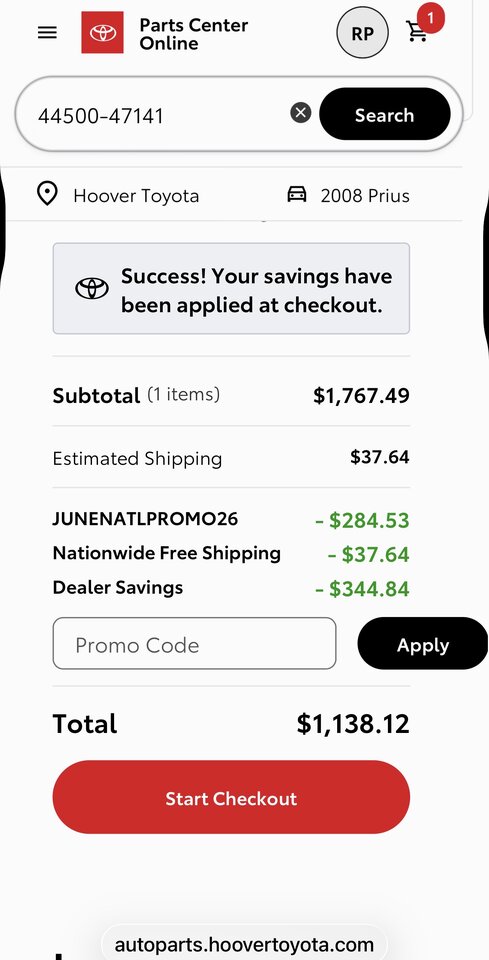

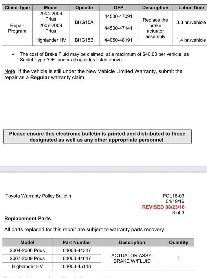

    No its not a good price. Look at post 16.
    Toyota provides kits with reduced prices when a tsb has been written
    Or you can get the standard part number with free shipping

    Thanks for the follow-up and heads up.
    The promo code wouldn't apply. I must be doing something wrong...

    Buy from the dealer listed
