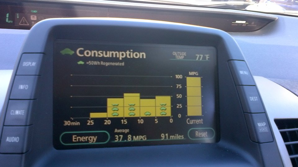

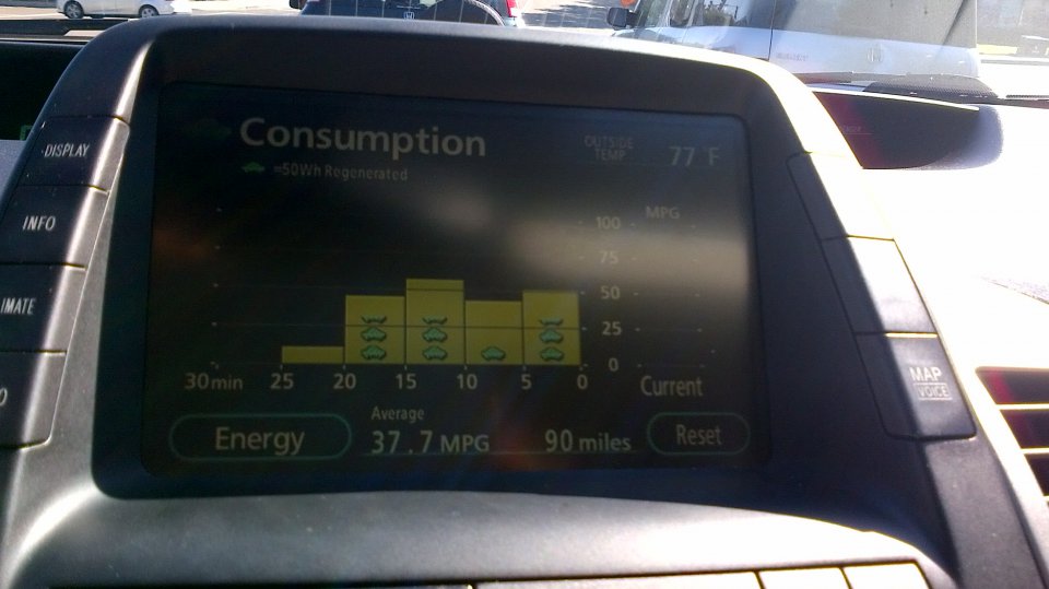

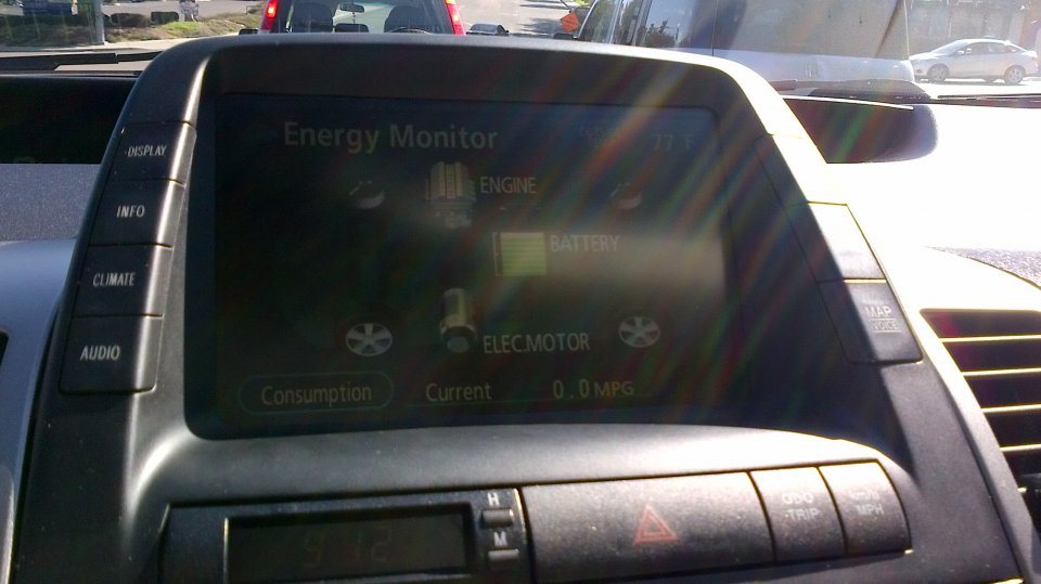

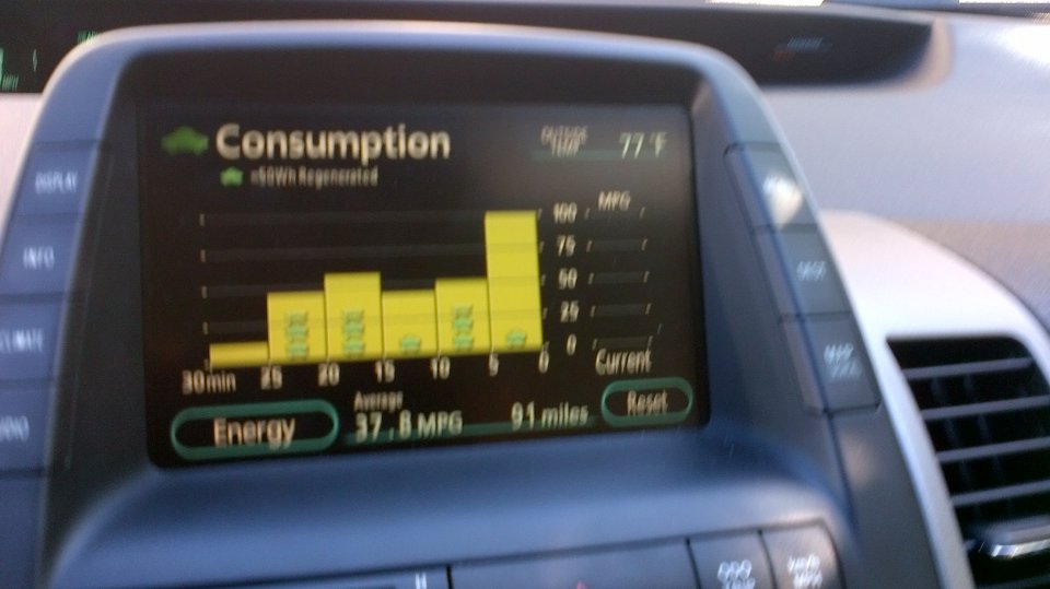

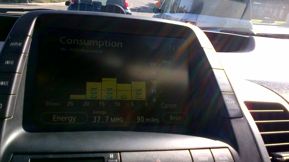

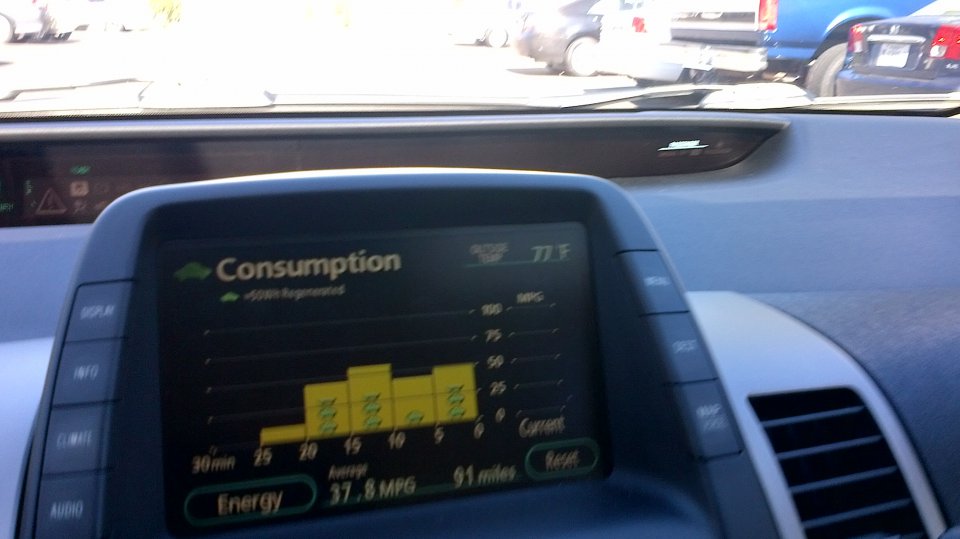

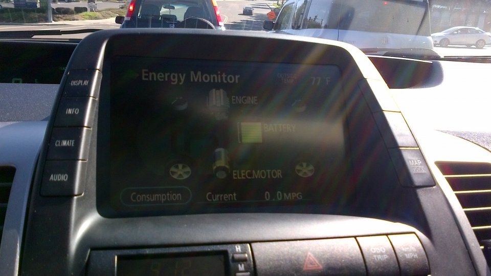

    here is energy consumption pics, i am getting 37.8 max so far.

    The 5-minte bars make it look like you should be averaging higher than 37. You have pressed the "reset" button in the lower-right of the screen, haven't you? Some observations are that your first 5-minute bar is lower than I've seen, you have more regeneration than I'm used to, and it's unusual for the battery display to be at all-green (8 bars) when on the flats, in traffic. Does it do that often?
    You are driving in "D" on the shifter, and not in "B", correct?
    The numerous regeneration emblems (green cars) indicate you are using the brake pedal considerably. Try holding back on the speed and anticipate stops better so you reduce the amount of braking.
    What are your first 5 minutes of driving like? Is there a hill climb?

  19. Autoconfig
    Autoconfig Junior Member
    Jul 8, 2014
    Bay Area
    next to my house we have 3 traffic signals plus fire engine office(not even 1 mile) , so i have to use break pedals with in 5 minutes and bit uphill near to my house, i did reset the button once when i got car, yes battery display all-green most of times.
    Yes I am driving in D on shiftere, i don't know what is B

    Hmm. This is a head-scratcher.
    It's very odd that the HV battery is all green most of the time. That usually only happens after a long and/or steep descent. It should be between 1/3 and 2/3 most of the time. You might pay more attention to that battery level as you drive (but still keep your eyes on the road). How quickly does it change? If you climb a hill, it should drop, but not too fast (maybe a bar every minute or two of climbing).
    B-mode on the shifter helps the car manage excess energy when going down long/steep descents. Don't use it for normal driving--it reduces fuel economy (it's wasteful with electrical energy).
    I don't know. You have fuel efficient tires. Your commute probably isn't optimal for fuel economy, but I imagine it should be doing better. If you have the opportunity for a different route, reset the average and take a drive that's 25+ minutes out in the open, where you can maintain 40-55 mph for a while and see how it averages. You might also try resetting the average after the car's been driving 10 minutes, so you cut the warm-up period out, just to see what numbers that produces.
