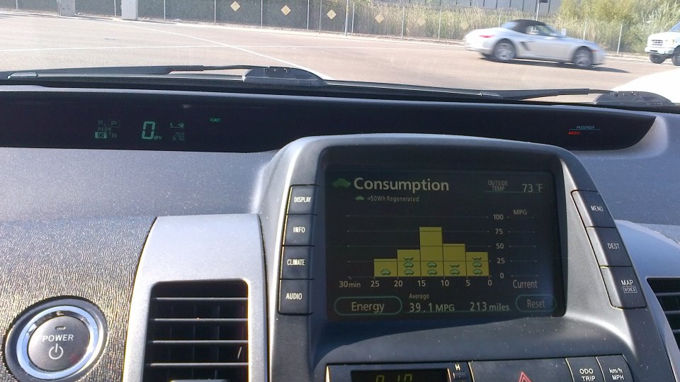

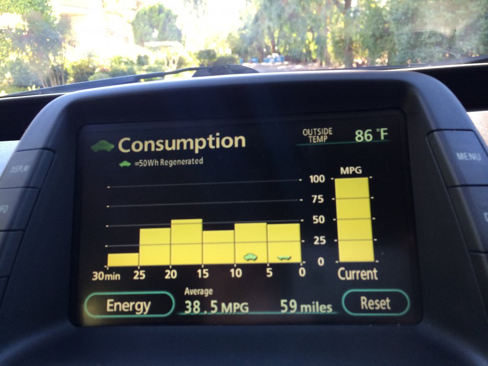

    I've taken car to local car service center for 105000 service checkup in miramar(Elite they are pretty popular) and they told me no issues with car and they did dig check but no issues reported, here is attached screen shots, now i am getting around 39.2 and 39.1.
    105000 service,and dig check,no error codes reported and battery looks pretty good ,correct me if i am wrong. my latest mileage around 39.1 and 39.2.

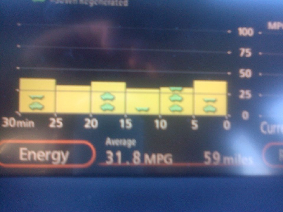

    with in one month, i am car mileage increased from 31.1 to 39.1
    i was getting 31.1 mileage when i bought car.
    now i am getting 39.1, is this good mileage i am getting right now.

    The aux battery report looks fine.
    You might try increasing your tire pressure. Try 44 psi front, 42 psi in back.
    39 mpg is better but it should be doing better still, especially in warm weather.
    There is still quite a bit of regeneration in your last screen photo. Have you worked on finding that spot in the go-pedal stroke where the energy flow is zero (or close)? Use the energy flow screen to help find it. If you coast with the go-pedal all the way up, the car activates a certain amount of regenerative braking, slowing the car (and usually reducing fuel economy). For coasting (unless you're trying to slow down), you should be holding the go-pedal down a bit.
    You might check your engine oil level to make sure the shop didn't overfill it. It usually only takes about 3.5 qts for an oil change, so it's easy to overfill.
