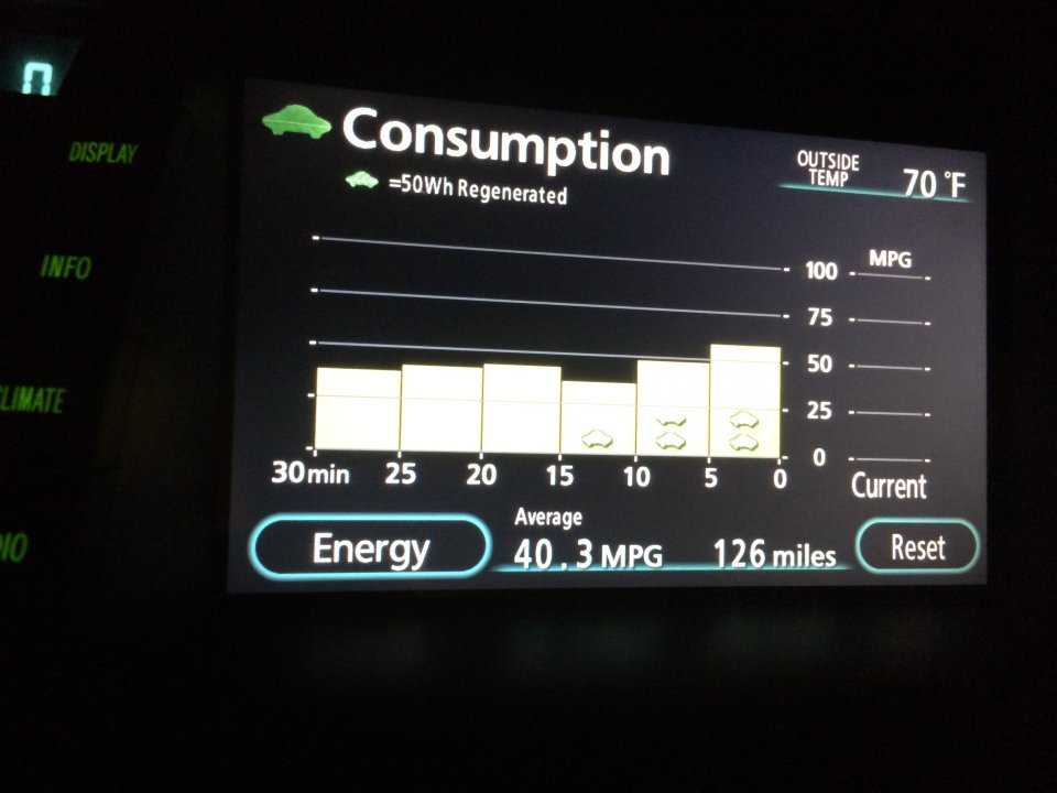

    Yesterday went to LA , I got around 40.3 to 40.4 round trip total 260 miles, is this good mileage ..?
    Its been month i brought Prius.
    First month fuel consumption update.
    completed 1008 miles.
    one month fuel: 35.26 gallons
    Total spent on 125$
    Started getting 32 miles per gallon initially when i brought car and now getting around 40.2.
    and when i coming back i can hear some small noise from front side small speakers next to driver , is this any known issue with Prius ..?

    Getting better, but I would still consider that to be pretty low. I've only gotten below 40MPG on one of my 46 tanks. Do you have a friend with a Prius you can borrow and see what you get in it? Or go to a dealer and test drive another Gen2, make sure you reset the MPG meter first. I feel like you must either drive crazy or something is wrong with your car.

    before traveling i went to service station and checked car, they said no issues with car, one of mechanic told me since i am new driver it will
    take while to get good mileage and need to understand art to prius driving.
    all along trip mostly i went over 70 MPH in highway, my friend in NJ right now i will check with him in once he comes back,

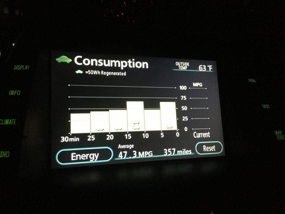

    I went to 400 miles plus trip on this week end,I got excellent mileage between 47.3 to 47.5 (with A/C on and some times heater on)and most of times my speed was 80 mph on highways.
    Spent 4 plus months to get good mileage and got excellent suggestions from u guys thank you all for making me real Prius guy ,started from zero 28 mph to 48mph now. image.jpg
