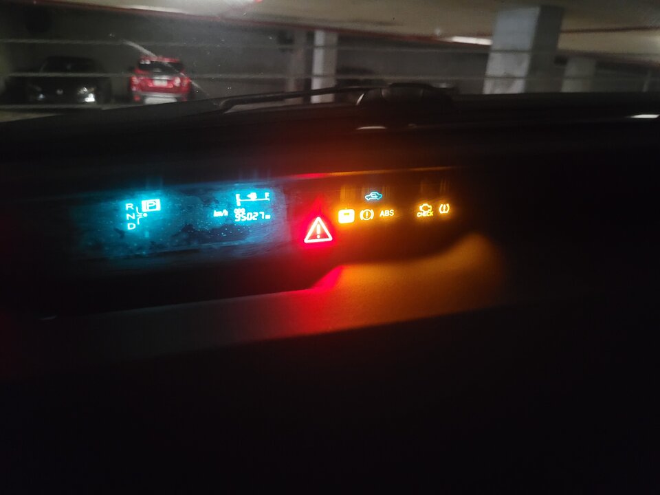

    Hello!
    I had an "engine light on" that my plug-in OBDII reader could not read. So I got Techstream on a Virtual Machine and connected it to my car, I turned my car on fully (ready mode) prior to having my Techstream App connect to the car. It ran for a single second, until the car engine turned right off, and then the Prius Monitor gave me the "engine problem" message before all the lights including the Red Triangle of Death turned on :))))))
    I have NO issues prior to this, I ran the car a few minutes before connecting Techstream in that same parking spot and it worked.
    I think my techstream/laptop might have miscommunicated with the ECUs and completely disconnected my Prius Computers from each other. Why? These are the list of codes I got, after re-running Techstream on a clean install, and connecting to the car before fully turning it on.
    Engine
    U0292
    P1121
    P1116
    Hybrid Control
    P0A1D
    P3000
    P3108
    U0100
    U0111
    U0129
    U0146
    HV Battery Live
    U0100
    U0293
    EMPS
    U0073
    U0121
    All having to relate to lack of communication between the ECU's Engine, Battery, ABS, etc...
    Has anyone had this issue before? Or better yet, how can I repair the Prius System to recommunicate with each other?

    Discovered the solution.
    CLEAR THE CODES!!!
    Then check all batteries. Mine weren't as good as before in voltage so I suspect some draining.

    I was just coming here to tell you that you're 12 volt is the problem when you have communication problems on the can bus in a car like this your text stream even though it's hacked and you're using a funny cable and all the nonsense usually will not break a car I'm not sure about the turning on the text screen before the car that doesn't seem right usually I have the car on sitting there ready or sitting there in accessory mode with all the lights on the dash I have text stream up on the cf-13 toughbook with the VCI cable plugged into the USB port and the other end that goes into the OBD2 port in my hand and then I stick that into the OBD2 port and then I look at my screen and then I click on the nonsense connect to text stream or whatever it has to detect the car and blah blah blah throw up the serial number it has to ask me if it has SKS or not and all that and so on and then that's it if tech can't connect to the can bus it's usually not a car problem it's a 12 volt battery problem if you discovered this is usually one of the first discoveries for us owners get to make or hear about if you're 12 volt is not above 12.5 in this AGM group size you're starting to lose voltage get down in the 12.2 and the 12.1 range and you are low and beyond that you might be in all those u codes or whatever they are I don't know those that well I only know the codes that come off the scanner off the MFD have no idea I have to look them up manually it's quicker for me to plug up the scanner and get the real codes I know a lot of those pretty well

    I've not read of techstream bricking a prius before... And sounds like you got it out of being bricked, which raises the question of it ever really being bricked?
    Once you have full power at 13ish volts and ideally a full charge and balance of hybrid voltage battery and reset and see if those codes return, let us know?

    It was at 11.8v yesterday after techstream, though I checked the diagnostic menu again and it said 14v just now. Maybe this was just a techstream issue.
    I'll keep that in mind. So far I'm good.
    Yeah I have a cheap dongle. At the same time I don't regret it. I will upgrade in the near future based on y'alls experiences with cheap cables. Techstream itself though, for being an old piece of hardware that's janky and expensive, can't be justifying it's price. Like Tom said the cheap ones cut corners. Lesson learned.

    The 14 volts is probably with the car ready no 12 volt battery is going to read 14 volts just sitting there after the car is turned off generally even right after it would be down to 13 volts by the time you got your test meter out and or it would be falling while you're looking at the screen 14 is usually ready take it out of ready mode and the charging stops from the inverter to the 12 volt then you'll be seeing 12 volt realistic voltage in non ready so two presses of the button with the brake not touched all the lights on the dash on an accessory mode now read the 12 volts in any scanner Toyota software included you should see the battery at 12:00 something and probably falling a 10th every few seconds or whatever until it stabilizes it whatever it's going to be at

    So I checked it right after start, and I even checked it while running. Only coming up at 14v. I checked it only in ready mode, but I'll check it in accessory mode. I'm ngl, your comment without the commas is fairly confusing, so I imagine you are saying to check in accessory mode for 12v? If it's bad or going bad, how would I be able to tell?

    You want to check the 12 volt with the car off and the alternator not charging the battery that's how it would be in a regular car so in the Prius we want to check the battery in accessory mode when nothing is charging the 12 volt battery or with the car completely off in the remote in your pocket. In the ready mode we're just being told that the DC to DC converter in the inverter that charges the 12 volt battery is in fact charging the 12 volt battery so we know nothing about the 12 volt battery in ready mode if that makes any sense,. Or not.

    Okay that makes sense. I can check it in accessory mode later today. Should it be at 12v in ready mode if its in good condition?
  15. ZillahG
    ZillahG New Member
    May 18, 2025
    16
    Hey! In accessory mode it shows 11.7-11.8v.

    Okay let's go back and regroup lot of times you lose a volt through transfer through the car so what do you have at rest at the 12 volt back at the 12 volt in the back of the car right on top of the battery after the battery has been sitting 15 minutes after the car's been out of ready mode not charging not on a tender nothing just sitting there if it's the same voltage you just reported 11.7 to 11.8 your battery is not up to snuff you are less than 12 volts at rest that's not good you should be 12 5 to 12 7 for this group size and an AGM format

    Totally discharged. Get that battery on a charger quick smart and it will not hold the charge, replace the battery.
