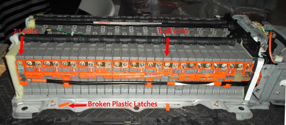

    I was going to ask you about my 2007 Prius. I had a problem with the car and gave me all those alerts in the previous post. I couldn't really get it on the scanner right. Anyways I had the chance to pull out the hybrid battery and I I did a quick check 1 cell is pretty low to dead and so as another one i in the lower side. I will have remove the connections tomorrow and do an amp meter check and voltage double check so I can get an accurate measurement and condition of the whole battery. What is your recomendable range per cell that I need to know so when I get the new cell, it will be all balanced and strong? Where do you recommend I buy these replacement cells?
    What else do I need to do besides replacing the cells and making sure I get it done the right way.
    Besides this situation on my car, It was running perfect and if I can fix this battery, Hopefully I get another 80k miles. Presently I have 174,186k miles. She's a beauty and I remember when you help me did the 100k miles service when it was 98,000 miles. It ran perfect till today. Anyways hope things are okay with you and hope you get this message.
    Thanks. CCG.
    BTW. should I worry about those broken orange plastic cover latches or is that normal part of the service operation..

    Worry about the broken plastic? I would probably glue the pieces back on, just to keep the wires covered in this instance, but I wouldn't be shocked to find that old plastic had broken.
    On the other hand, when I received a new OEM battery with a whole lot of broken orange plastic it went right back to the dealer, as the only way that would have happened is if they dropped the crate in transit.

    I broke the orange parts because this is my first time working on one. I kept everything and I'll glue it the right way.

    Call your local Toyota dealer's parts department and ask for part number G9510-47033. Prices will vary and ask specifically whether they will sell the battery pack over the counter. Take into account the normal $1350 core charge and what their shop's terms on on refunding the core. I had quotes back in May '25 from $2045 to $3300 from 5 dealers in my area. The new pack from Toyota will include the entire pack with new wiring, power cables, and buss bars. You will need to transfer from your old pack: metal end cover, rubber vent hoses, the black plastic block near the ECU end, and the entire ECU/terminal/relay section over to the new pack.
    Otherwise, the only other source of these nimh modules will be used/reconditioned of unknown age and capacity.

    I'm just rebuilding it. Not the whole assembly.

    I was able to test each cell and besides #18 is a bad cell that needs replacement. What is the minimum voltage after doing the load test? So atleast I can replace it if necessary at the same time.
