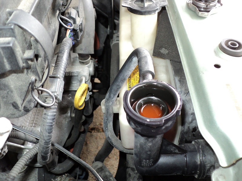

    Sounds like you are low on coolant. Check to make sure there are NO leaks. Once you confirm there are no leaks, then remove the upper splash guard over the radiator. When the ICE is "cold", remove the radiator cap. Look inside the neck directly underneath where the cap normally sits. If it does not look the picture below you are low on coolant.
    If it doesn't look like this, then add the Toyota Super Long Life Coolant to the radiator until it is full. Then put the Prius in maintenance mode. Turn the heater on full blast and set the temperature on HI. Allow the ICE to warm up completely to cause the thermostat to open. If you rev up the engine some while it is warming up, it will make the thermostat open faster. Once the thermostat opens the coolant level will drop again. Once it drops down add more SLLC to the radiator until it is full. It might help you to open the bleeder valve on top of the radiator also to help get the air pockets out of the system. If you do open the bleeder valve, once you see coolant coming out of the valve close it up. That will tell you the radiator is full and that the air on top is gone.
    The gurgling sound is due to trapped air. It sounds like the mechanic who did the work for you did not bleed the system properly. You need to get ALL of the air out of the system. Once it gets hot (summer time) and you start using the A/C the ICE will overheat if there are air pockets present.
    Once you get the radiator full put the cap back on and drive it. Then let it cool down and repeat the process until the coolant level looks like the picture above when it is COLD. Once it does that, you are good to go. Then put the splash guard back on and pat yourself on the back for a job well done. It is a good idea to check the radiator when it is cold about every 30 to 90 days. Don't rely on the overflow bottle by simply watching it. At times the radiator can drain down and the bottle still look full. The only way to truly determine the level of the coolant is to physically remove the cap and look inside the radiator neck.
    Lisle makes a great funnel for doing this work. Makes it real easy to get the air out and bleed it quickly. Also a airlift tool will help immensely. But you can do it the way I described above. It just takes longer.
