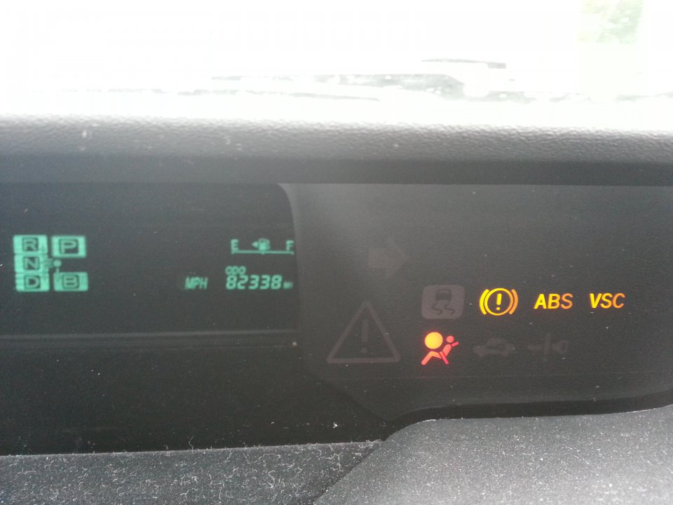

    I have a 2007 Toyota Prius and it was driving well (till yesterday morning).
    I parked my car yesterday in my office parking lot and when I came back (after couple of hours) I noticed that my car was not responding at all.
    I couldn't open the doors using the remote, hence I opened the doors using the keyfob and got in to the car to notice that none of the lights were working.
    I tried to start the car (pressing the power button) but all the lights in the dashboard came on for a minute and stopped again all together. I tried to start couple of times and got the exact same results (attached with this post).
    I had to get back to my work then and came back to my car after couple of hours. This time, my car died totally. I could just see the green light on my power button but pressing it didn't even display the dashboard indicators.

    At first your story sounds like you could have had a weak or dead 12v battery and a third attempt to start the car may have worked.
    However it only takes one jump start with reversed polarity (attaching the negative lead to the positive terminal) to blow the fuse and damage the inverter. The warranty doesn't cover this situation.
    I'd start shopping around for an inverter and an indy garage like Luscious Garage for the install. Also check the voltage of the 12v battery and replace it if it is low.

    If the DC/DC 100A fuse was blown, that is circumstantial evidence that the jumpstart was botched and therefore the inverter was damaged due to negligence on the part of whomever did the jump.
    The good news is that a used inverter can be bought for a three-digit amount and it is not very difficult to replace.

    There are a number of stories here about reversed jump starts by AAA and the like. It happens more often than one would expect. It is trivial to jump the Prius as no major current is involved, so if it didn't work the first time then that would be the likely scenario.

    Yeah it definitely sounds like the initial problem was nothing more than a flat (or failed) 12V battery, and that all the other problems have arisen from a failed jump start. I'd be 99.9% certain of that, particularly with the blown fuse which is pretty much a sure sign.
    It's more likely that the AAA guy did the damage than the dealer in my opinion. The dealer tech would know for sure to use the front jump terminal (under the hood), which is pretty hard to get wrong. The AAA guy might have gone straight for the battery (in the rear hatch) which is a bit darker and harder to access, and a lot easier to make a mistake.
    Do you remember seeing where exactly the AAA guy tried to jump it? Was it up front under the hood, or was it in the hatch at the rear?

    AAA guy opened the fuse box (That's what it said on the box) under the hood and connected the red clip to a clamp (below a red flap with +ve sign on it) and connected the black clip to the bolt under the hood.

    Good so far. The next question is what was connected to the other end of the cable that the red clip was attached to.

    It was some portable jump starter kit. My car was sandwiched between 2 other cars (in parking lot) so I had to wait for AAA to bring the portable jump starter kit.

    If it was a portable jump kit and you witnessed the AAA connect the car correctly as stated in your post 8 then the damage must have been done at the dealers.
