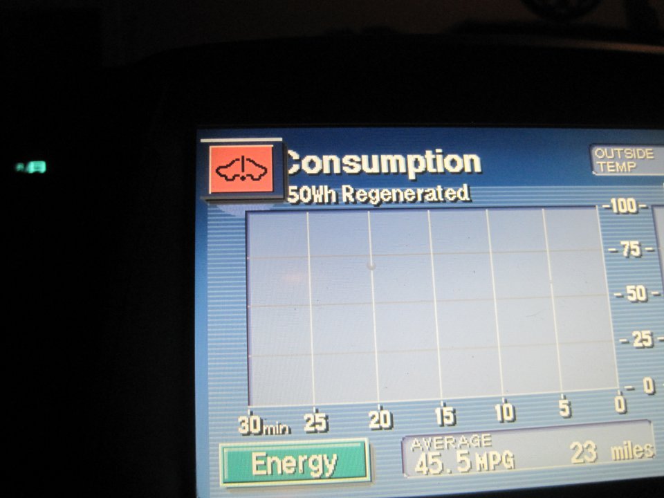

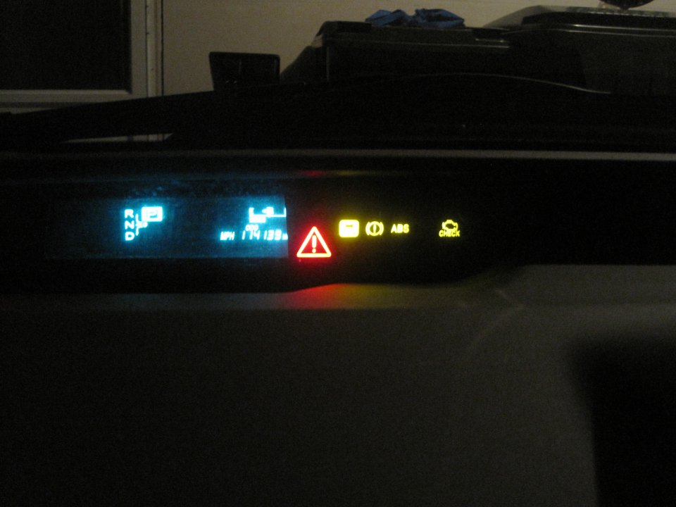

    My problem started about two weeks ago. The red triangle came on with the brake warning indicator. After I stopped the car, it wouldn't start again and several more indicator lights came on.
    I took it to the dealer and they replaced the auxillary 12V battery.
    I picked up the car, I was driving on the freeway, the same red triangle light came on with the brake indicator light.
    When I stopped the car at my destination and tried to start it again, the same warning indicator lights came on. I had it towed to the dealer. The told me the diagnostics gave them a code P0AA6 and 526 and told me I needed a new inverter, a $3600 part. I found a used inverter and drove the car to a repair facility that works on hybrids. They installed the used inverter and I drove the car to a restaurant near home about 20 miles away from the repair facility.
    When I left the restaurant, the same red triangle came on again and when I got home and tried to restart the car, the same multiple warning indicators came on as originally when I took it to the dealer.
    Any input that could help diagnose this problem would be appreciated.

    I believe that you posted about this in another thread. Your car has a high voltage ground fault. It appears that the inverter is not the issue. The ground fault could be due to any component that is exposed to high voltage.
    The troubleshooting approach requires use of a megger (which is an ohmmeter that uses a high voltage) and disconnection of the various components, to determine where the ground fault is coming from.
    Here is an example of a ground fault which was determined to be from the transaxle:
    Luscious Garage | Blog | Gen 2 Prius (2004-2009) Transmission Failure, P0AA6, P0A92, P0A7A

    To follow up on Patrick's post above, here is the DTC information for a 2010 with P0AA6 with subcode 526:
    P0AA6-526
    Hybrid Battery Voltage System Isolation Fault
    - Hybrid vehicle transaxle assembly
    - Generator cable
    - Motor cable
    - Inverter with converter assembly
    - Frame wire
    - No. 2 engine wire
    - Hybrid battery junction block assembly
    - Compressor with motor assembly
    - HV battery
    - Battery smart unit
    I would expect your 2007 would be similar. The dashes at the bottom lists the possibilities.

    No. The master warning red triangle simply means that a problem exists.
    A brake warning light means that the skid control ECU has a problem.
    The high voltage ground fault would be reported by the hybrid vehicle ECU and the hybrid vehicle warning icon would normally appear in the upper left corner of the MFD. However the nature of the problem would not become apparent unless the DTC were read.
