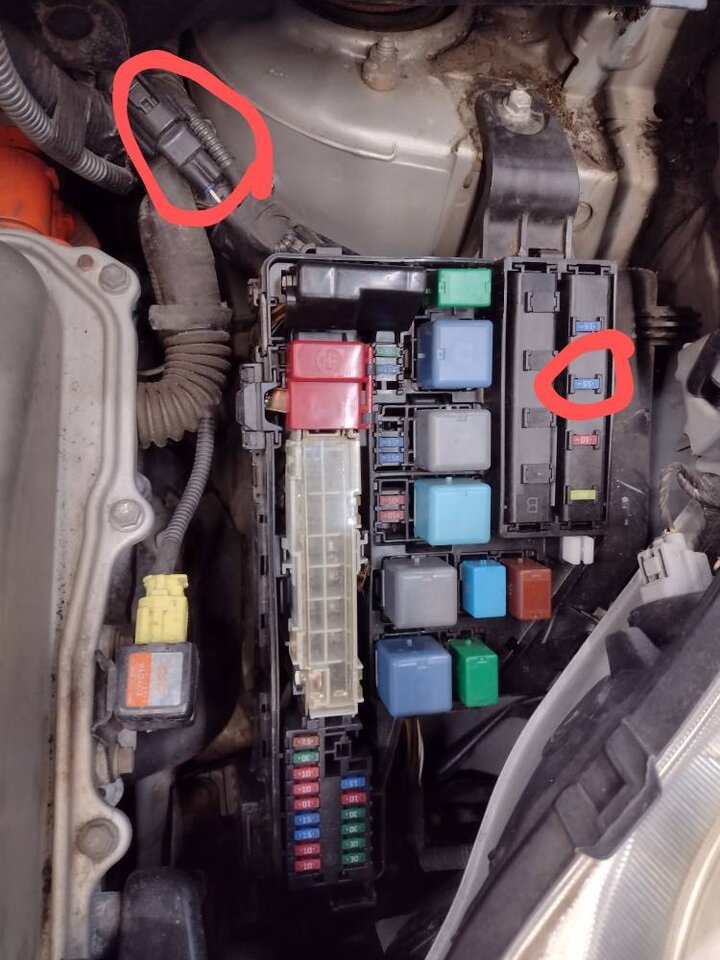

    Initial guess based on your symptoms - check the AM2 fuse in the underhood fusebox. If it's blown then the inverter water pump has likely failed (shorted).
    That fuse supplies ignition power to several other systems on the car. No AM2 = no turning on.

  10. Hayslayer
    Hayslayer Active Member
    Nov 6, 2024
    539
    331
    If you think it's the AM2 (and your symptoms are similar), there's a small one wire connector just above the underhood fusebox. Unplugging that connector will remove the inverter cooling pump from the circuit. Then replace the AM2 fuse. See if the car powers up. The car can be driven quite a bit without that pump running as long as you stick to non-highway speeds.

  11. mr_guy_mann
    mr_guy_mann Senior Member
    Sep 3, 2020
    4,120
    2,018
    NJ-USA
    Here's the AM2 fuse, and the connector that will disable the inverter water pump as mentioned. gen2%20fusebox.jpeg

  12. SarcasticFringehead
    SarcasticFringehead Junior Member
    Nov 14, 2021
    47
    UK
    It’s not the fuse/inverter pump, unfortunately.
    The garage has told me the signal from the key is not getting through. (Yes, I tried the other key.) They’re going to check the wiring and if they can’t find anything they’ll have to put hours of labour into stripping it down.
