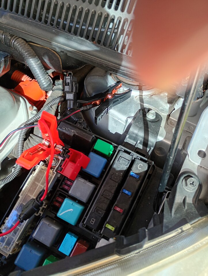

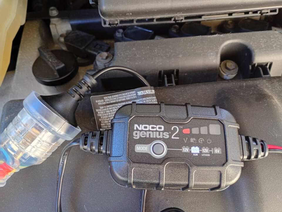

    Ok, the battery is a Spill Resistant sealed unit, so I'm presuming AGM.
    Hooked up the charger to the under the hood terminals and set it to AGM charging - starting off a lowest charge state I believe.
    Waiting to see if anything bursts into flames :)

    Huh - fully charged (green) already after just 4 hours - should I leave it on for 24 hours anyway?
