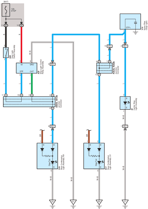

  5. ColoradoCrow
    ColoradoCrow Senior Member
    Sep 2, 2019
    1,108
    464
    Leawood, KS
    I
    i found this... stilll searching under brake light schematic

  8. ChapmanF
    28,743
    19,042
    The stop light switch is wired to a bunch of different places. There's a "stop light control relay" too (not really a relay, more an electronic gizmo, but that's what they call it) on the way to the lights in back, but I wouldn't worry about that right away as far as starting the car.
    I would look at the "hybrid vehicle immobiliser" section, or the "hybrid system, shift control system" section, in the wiring diagram.
    Toyota Service Information and Where To Find It | PriusChat
    They show the side of the stop light switch that's supposed to be open when you're not pressing the pedal wired to the STP terminal on the power management control ECU. This seems to be how the ECU decides if you are pressing the pedal and should go to READY instead of ACC or IG-ON. That circuit just runs from the switch to the ECU, doesn't involve the stop light relay.
    The switch has another side that is supposed to be closed when the pedal is not pressed, and opens when the pedal is pressed, kind of the opposite of what the first side does. That's also wired to the power management control ECU, terminal ST1- (the trailing - probably indicating a signal with the opposite sense of STP). I think that one is just used for canceling cruise control, but testing both sides wouldn't be much more work than testing one.
  9. Dustin Lowe
    Dustin Lowe New Member
    Jul 23, 2023
    Central Texas
    FIXED!!! Turns our it WAS a bad fuse. I had visually inspected them and couldn't see anything wrong so I started swapping them out just to be sure and BOB'S YOUR UNCLE! It started and drove as it's supposed to!
