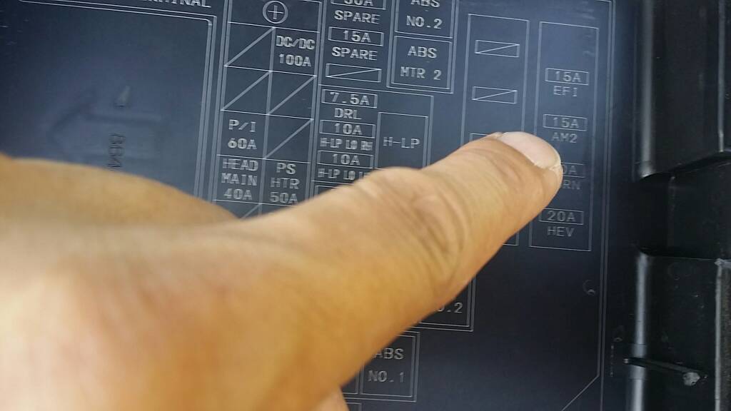

    I think you blew the AM2 fuse, from a short in the inverter pump. Have you done the recall on your car?
    You can check the fuse which is located in the engine compartment fuses
