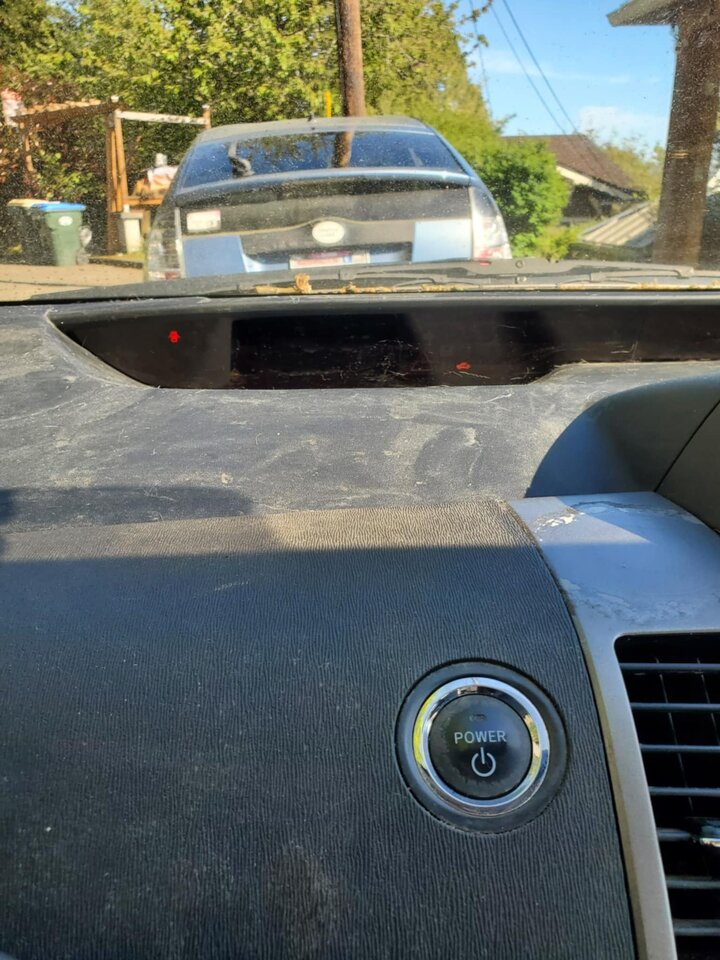

    I have two prius vehicles right now. A blue 2005 and a silver 2007. Blue is my daily driver. The Silver prius is that one that won't boot up and show dash lights.
    I bought a new battery for the 2005. I tried it in the silver prius first and it gave same results as before. The car won't boot up and show any dash lights.
    I pulled that battery and tried it in the blue prius, the blue prius started right up. I took the relatively old battery out of my blue prius that was starting blue prius just fine, it did nothing for the silver prius.
    I have concluded that the problem is not with the 12v battery.

    I have brake lights and I have emergency flashers. Nothing else lights up in any way. I was able to get it to run dash lights when I picked it up. It would not go into "Ready" mode, but it went into the mode where P and N are available. That was helpful in getting the car loaded up on a dolly for ride home.

    From the video, the car sees the power button push, else the voltage wouldn't drop like that. The dash lit up once when the OP first took possession (first post). Was that both the combination meter (dashboard) and the MFD? Failure of the combination meter to light up is a very common problem on these cars, but it is separate from the MFD not working. There is a very long thread on it here:
    combination meter repair - DIY | PriusChat
    Combination meter failure doesn't normally keep the car from starting, but it often makes turning it off difficult. (Rather than a single push to turn off, one must hold down the start button for several seconds. Like a forced power off on a PC.)
    The OP reported having checked the AM2 fuse, but not the status of the others. It would make sense to check all of the fuses. That said, I'm wondering if rather than a bad fuse this isn't a bad relay. I don't have the electrical diagram for this car handy but in most vehicles there are one or more relays which need to click in to connect power from the battery to the various other electrical systems. If those relays fail, the car will have problems, usually big ones, very much like what is seen here.
    Is it possible to read codes, preferably with Techstream or an equivalent?
    After the car is started, is there 12V at the power outlet under the glove box? If not, perhaps start by working that problem. It should be a relatively simple circuit, and if that starts working perhaps some of the other problems will be resolved too.

    Ok, making some progress. I now have a light on the dash that indicates a door is open. I also get the little key in a red rectangle that indicates no key in place, or system is locked or whatever that one means. The key fob also unlocks the doors, but it does not lock them. I just get a long beep. I figure that maybe that has something to do with the system thinking there a door open.
    Started on this late today, it's pretty warm, so I am taking a little progress and calling that good for today. There were no blown fuses under the hood. I scraped a little oxidation off a few of them. Think I will shoot them all with electric contact cleaner.
    No voltage reading from the socket under the glove box.
