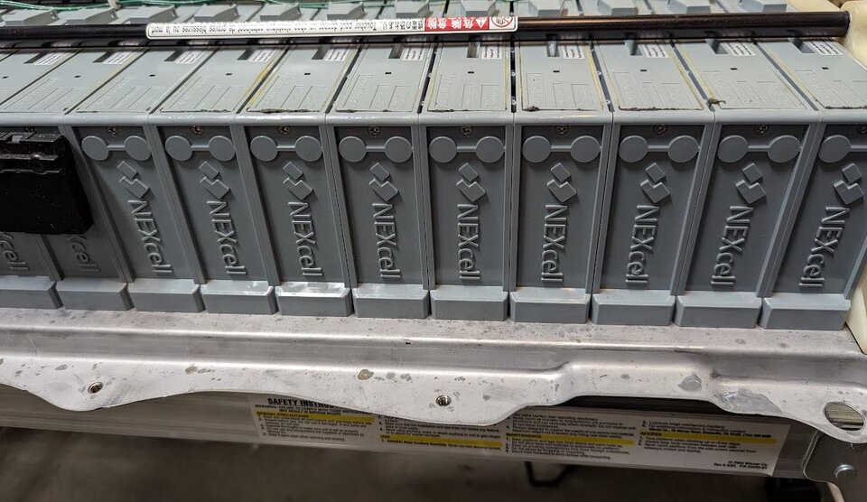

    Update:
    Brand new factory OEM HV battery installed, all in $2060 out of pocket. Part number G9510-47033. Battery date appeared to be 2024 September Primearth EV Energy Co Ltd made in Japan.
    I picked up a battery ECU off eBay for $100 that was corrosion free for an extra peace of mind. Original ECU still worked but evidence of previous corrosion on 3 pins of the module balance harness connector. The task of transferring the components off of the original pack over into the new pack was daunting so I carefully took my time, torqued the 4 nuts to the +, -, and cutoff terminals to spec 5nm. Made sure the metal battery pack end cover was installed in the correct orientation as the previous assembler/owner put this plate in reverse. I also discovered several 12mm and 10mm bolts missing and not original.
    Overall, good experience so far and hopefully I don't encounter any more traction battery issues. I can't imagine the previous owner had this experimental short-lived lithium pack installed probably not more than 2 years ago. Going off of another recent post https://www.priuschat.com/threads/time-for-a-new-traction-battery.238103 these packs sold at full cost $2300+ :eek: .
    Old pack RIP
