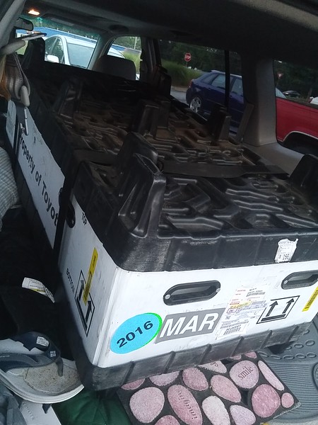

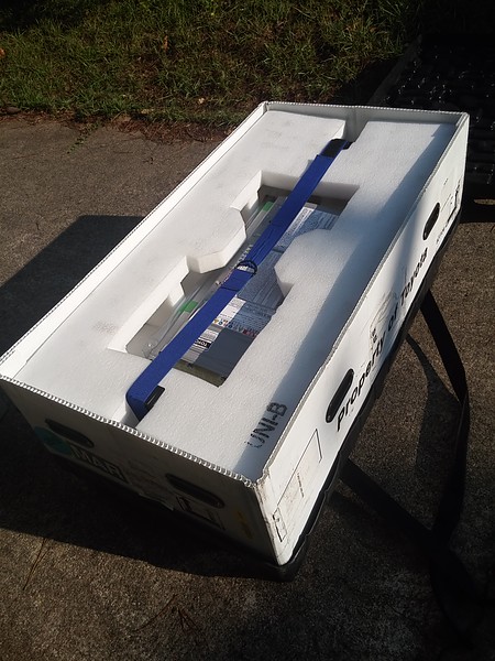

    The battery in the shipping container in the back of my Highlander bringing it home. Shipping container must be kept and used when taking the core back to the dealer.

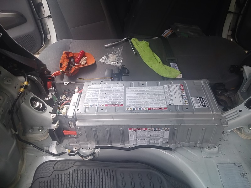

    Taking the old battery out. I looked at a couple of You Tube videos and followed them in removing the trim and battery. Fairly simple.

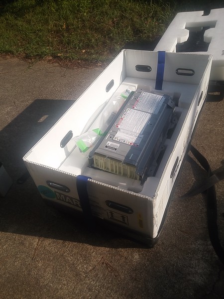

    The new battery in the shipping container.

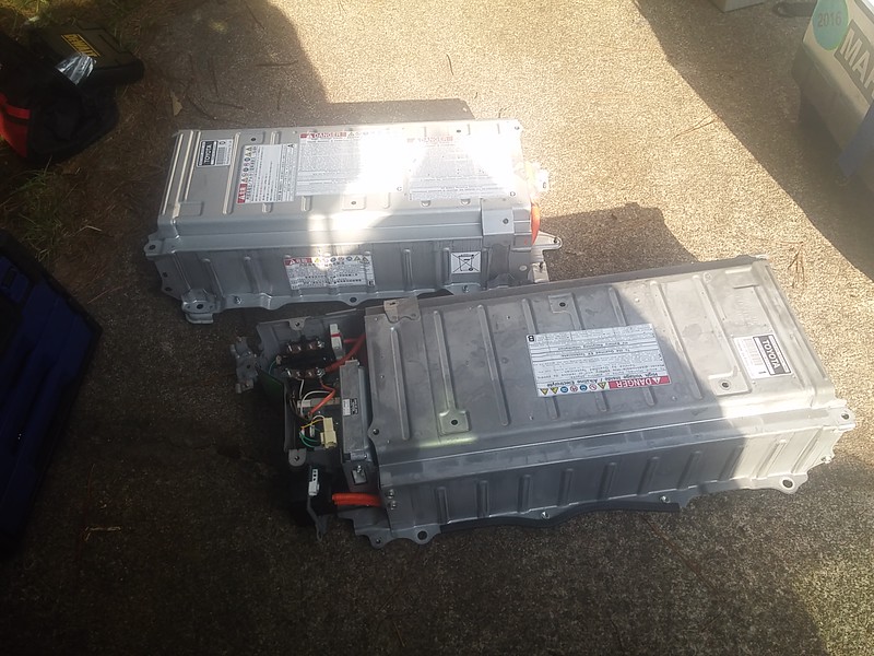

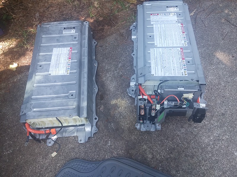

    New and old batteries side by side.

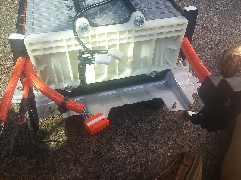

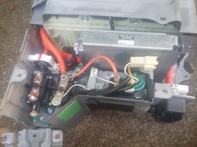

    The electronics on the old battery which had to be moved to the new battery along with some other wires and parts. Actually Toyota included new wiring that attached to the battery.

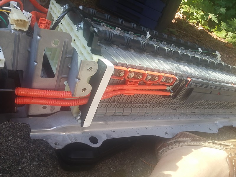

    This is one side showing the wire that has to be installed on the new battery. Also some on the other side as well. That is the old battery and you can see some corrosion on it.
    The new battery and I was starting to install the electronics on it. I did take addition pictures as I went to be able to look at while doing the install.

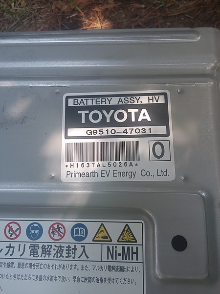

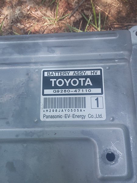

    Old battery label.
    New Battery label.
    Old battery on left with no electronics and new battery on the right with them.

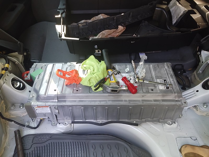

    The new battery going in.
    I did get the new battery in and hooked up only to find it not working right. I had worked outside in the heat for several hours and had to leave it for the next day. I got up and checked the orange plug and the 12 volt connection and they seemed fine but the car did not start and I got an odd code. I made a couple of phone calls to Prius battery folks. Tampa Hybrid and Eric here on Prius Chat. Both guys were very nice and helpful. After getting their opinions I dove back in and took the electrical end cover off to check my connections. I founf my bone-headed move. One connector which was under the wiring was not fully seated. So I made sure they were all tight and put it back together.
    I was successful in installing the new Toyota battery. It ran great. I boxed the old battery up in the shipping container and took it back to the dealer in my Prius to get my core deposit back.
