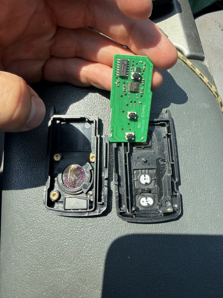

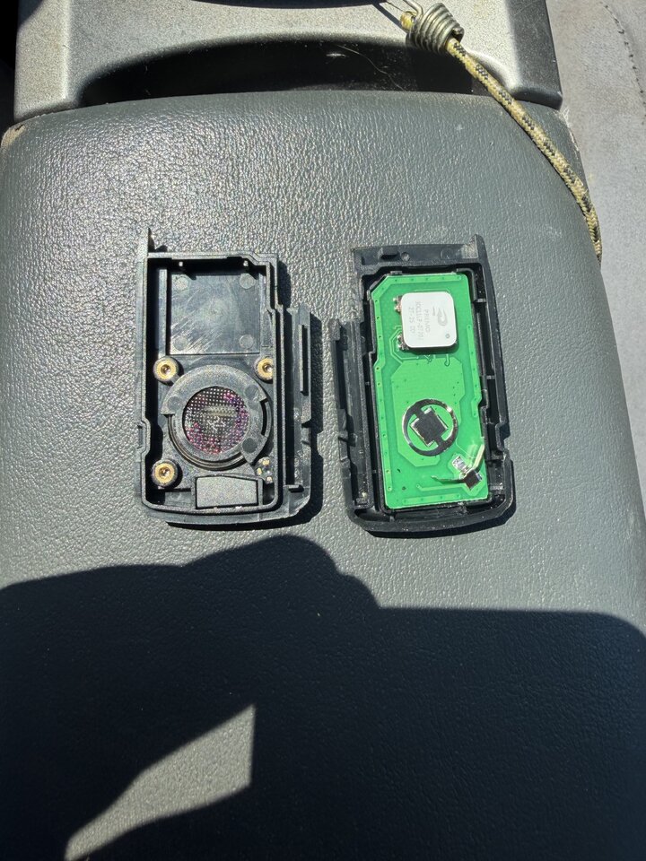

    Hello,
    2 weeks ago I got a new smart key programmed for my 07. Everything worked fine, the lock, unlock, alarm, opening locked door with key in pocket, starting car with key in pocket.
    a few days ago the opening locked door with key in pocket and start car with key in pocket stopped working. I’ve tried the button under the dash, unplugged 12v battery, replaced battery in fob and putting key up next to the start button and pressing start. None of these have solved the problem.
    the lock, unlock and siren buttons work fine. I called the locksmith I used and he doesn’t have a clue and says it doesn’t have anything to do with their programming since it worked fine up until a couple days ago.
    anybody have any idea? I’m not sure if the key they provided and programmed is a cheap knock off or not but it doesn’t have anything Toyota logo on the back, although my old one I lost didn’t either and it worked fine for years.
    really hoping to figure this out because I spent $280 on a new key and would like to utilize all the smart functions.
    thank you!
  2. Tombukt2
    Tombukt2 Senior Member
    Nov 29, 2020
    13,839
    2,514
    Durham NC
    Well the new remote that you bought from the locksmith or wherever you got it is not Sonic welded so it should pull apart show us the board and what's in case . I'm thinking a knock off . But the fact it worked . Should be able to work again . Should be a sticker under remote parts .
