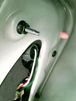

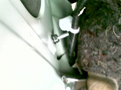

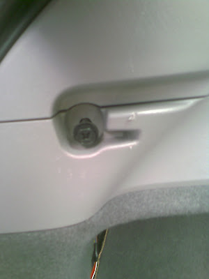

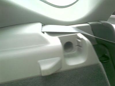

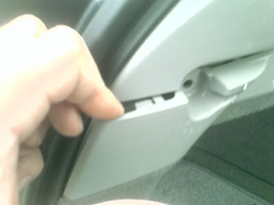

    It's not so clear from your photos or instructions: the two nuts (not bolts) to be removed are located between the bulb cluster and the hatch door. Also attached to the bolts are white plastic ties that hold a black cable (perhaps someone had already been in your car and pulled them off?). Pull off the plastic ties with a pliers. If you don't have a 2"-deep socket for the nuts, a wrench will work fine. On the outside of the car, a thump on the inner side of the lens with the heel of your palm will set it free.
    The taillight can be removed WITHOUT removing the inside wall of the trunk, though it's a little harder. To do so, remove the bulb access cover. At the inside edge of the hole (as you face it, left side for a drivers taillight, right side for a passengers taillight) there will be a black cable. Follow it up to find the top bolt - it will be 2" above the hole. Follow the cable down to find the lower bolt - it will be 1" below the hole. To pull off the wire ties, slide a pliers over the bolt shaft behind the wire tie and pull towards you. Use a 10 mm crescent wrench to get the nuts started. If you push in on the lens, you might even be able to unload the nuts enough that you can untighten just with fingers.
