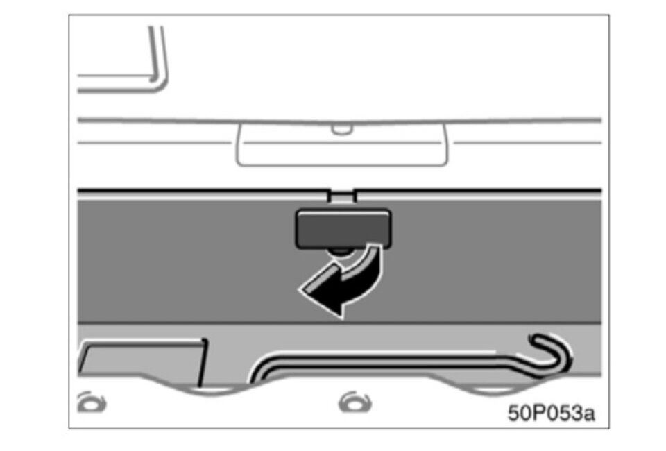

    I bought a 2007 sight unseen for way too much money and finally my luck ran out. Bad hybrid battery. To make matters worse I can't even open the lift gate. The little silver thing on the inside is stiff and it won't rotate to open the door. I just tried it on my daily to make sure I have the idea correct and it opens no problem. How am I going to get the liftgate open if the manual lever doesn't work??

    From the inside near the hatch latch there is a little silver tab that if you lift up it will open the hatch. In theory. It's like my silver little thing is already stuck up and not actuating whatever it is supposed to release.
    No go with the 12v. The switch is in rough shape from heat damage, but it does try to do something. You can hear it make a clunking sound, but the hatch is still firmly shut.

    On a gen2 the rear latch motor is in the floor. As a result you pull the hatch floor up to access the manual release.
    Remove cover of latch motor​
    IMG_0778.jpeg Once I had to move the manual release while jiggling the hatch door from the inside. There may be a way to unbolt the latch motor from that same access. Or if push came to shove pull out the angle grinder and try to cut off the strike.

    If electrically it clunks but doesn't unlatch, and moving the lever (that you know from another car is the right lever) doesn't unlatch, it would seem something has failed in the latch. That doesn't seem like a common issue anyone else here would have advice about. It'll be a challenge. You may have to look for ways to carefully destroy the latch or the strike without destroying what's nearby.

    Usually the latch has cloth or plastic jammed in it.

    Any sign the hatch or nearby areas are or were bent? Pretty common for hatches, trunks, and doors to refuse to open if they are bent enough that it puts force on the release mechanism.
    If it sounds like the release is trying to open when 12V is present perhaps just try prying the hatch open "gently" when the latch should be open. Bang on it a bit. Push outward at the bottom, inward at the bottom, left or right near the bottom.. Pry up from the bottom, it might just be glued shut because the rubber seal stuck the hatch to the body. If still no go, take apart the panels around that area on the other Prius and see if there is some obvious way to disengage the latch arm with minimal mayhem. As in, find the best place to cut.
    Has the OP tried a little "persuasion" on the manual release lever? If it is in the "latched" position perhaps a small crowbar across a block of wood can force it up?

    You're gonna have to pull as much stuff out of the back of the car as possible to get better access to the metal clip so you can put way more force on it to get it open.

    Thanks a ton to everyone who chimed in. Reading all your posts before I work on it again helps me get my head in the right place. I took out the 3 bolts holding in the black latch mechanism to the car (not easy with the gate closed) and then was able to crowbar it out of there. Once the gate was finally open, one could easily finger it from the other side and it released the strike. I think the problem was rear end collision damage pushed on it just enough the mechanism ceased to function normally. Unfortunately the crowbar removal wasn't without collateral damage and now the nest of the car frame is in pretty bad shape where that black latch mechanism tucks in. Will make securing the 3 bolts, alignment and latching function certainly difficult upon reassembly Yet I now have to turn my attention to figuring out how to split and fix the hybrid battery. Thanks for the pointers on that front, I'll do what I can to figure it out and let you guys know if I have any questions.
