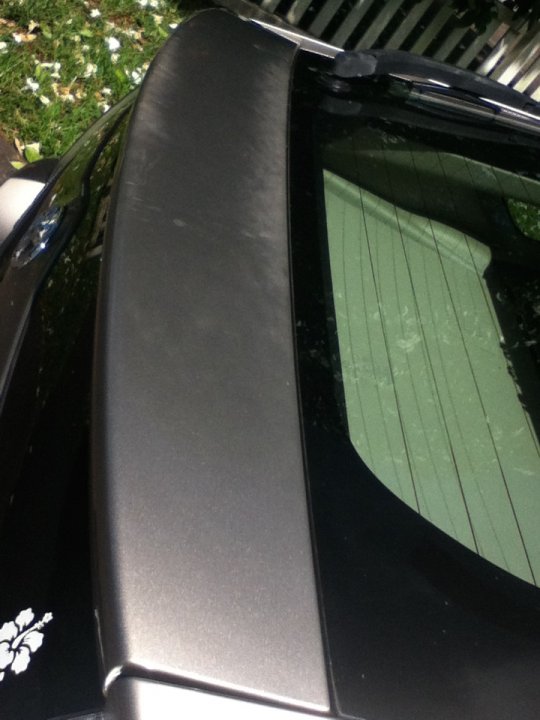

    IMG_0006.jpg View attachment 71271 View attachment 71271 2008 Rear Spoiler (paint) oxidizing ...anyone else ? Local body shop says they see it on Prius ..Plastic spoiler not paint on metal / also they think itʻs just the clear coat.

    Yes, this is happening on both my 2004 and 2007.

    The fix is removal, sanding, primer, and repainting. I haven't done this yet and probably won't. I thought it was interesting that the oxidation is linear, perpendicular to the airflow. Maybe this has something to do with how the part was cast. It almost looks like what happens to regular unstabilized plastics exposed to ultraviolet radiation. The paint is sloughing off of my rear door handles also, mostly on the horizontal surfaces. The Arizona sun is exceptionally harsh.

    Easy and fun fix with plastic dip! Remove spray and return[​IMG]

    Same problem on my 2008 blue Prius. For a cheap fix I applied a light solvent (WD40) to a small area and let it set for a few hours. I then very carefully scrapped off the oxidation with a fresh razor blade. The original finish and shine returned with only a few small gouges where the razor blade dug into the paint. I will follow-up with touch-up paint on the few gouges. Agree with you guys above that a good continuous wax job would have been the needed ounce of prevention.

    It isn't just a Prius issue. My Lexus RX400H 2008 has the same problem and I waxed it twice a year. The issue is the base material is different and it needs an epoxy primer applied to keep the base fibers from cracking/hazing through to the top coat. Toyota/Lexus should paint the spoilers separately with the proper primer coat. All the Lexus RX we see here in hot California have the same issue.

    Why bother with removing the spoiler? This YouTube video that shows you how to remove the oxidation with Lukat Fixit:
    Takes a little elbow grease (or use of a drill with a polisher attachment), but so much easier than removing and repainting. I'm told it's UV that causes this, so you might want to spray it afterwards with a UV protectant, and follow up with the protectant every 6 months to a year. Not that hard.

    There's actually no need to take the spoiler off or use a ton of elbow grease if all you are trying to do is restore the spoiler to match the rest of the car so the fading no longer shows. Our red Prius started having the problem and I just realized I hadn't posted how I fixed it. It was actually quite simple.
    After lightly wet-sanding the top of the spoiler I used blue painter's tape and newspaper to make sure no overspray would get on the window or the rest of the car. A can of Dupli-Color Perfect Match in Barcelona Red was ordered from Auto Zone. I sprayed multiple light coats on the top of the spoiler. After all, it's only the top that is fading. I followed that with a light spraying of Dupli-Color Perfect Match Clear Top Coat and the job was done, on the car, in a day. All for less than $20. A year and a half later it still looks good and I still have a half a can of each should it have to be redone in the next couple of years.
    If you're patient and careful, no one will ever notice you repainted only the top.
