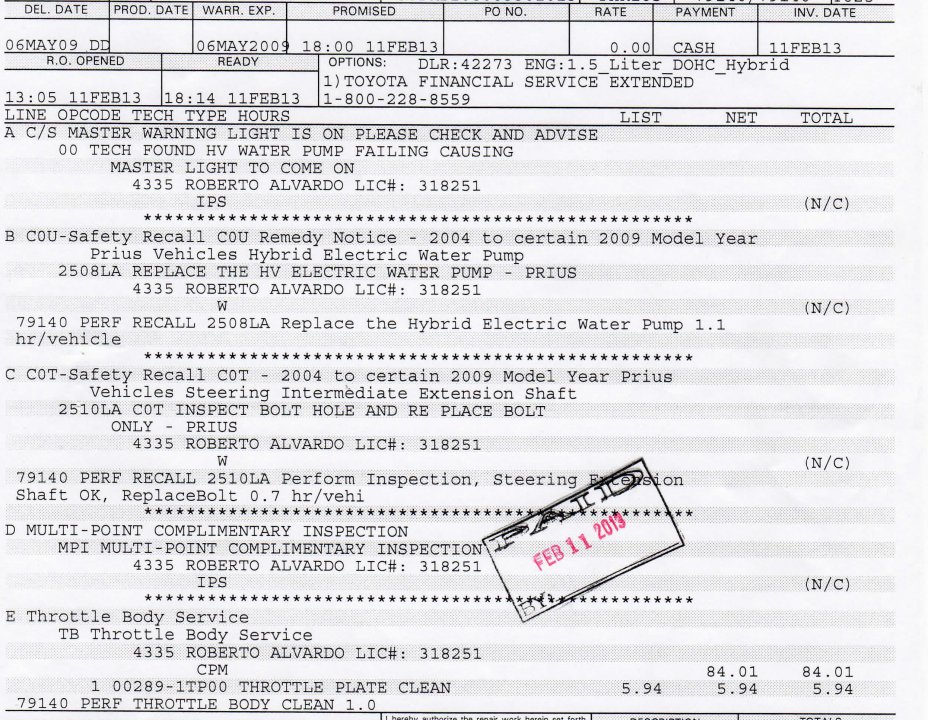

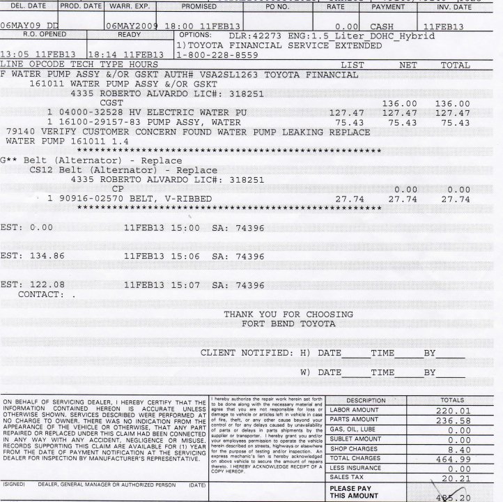

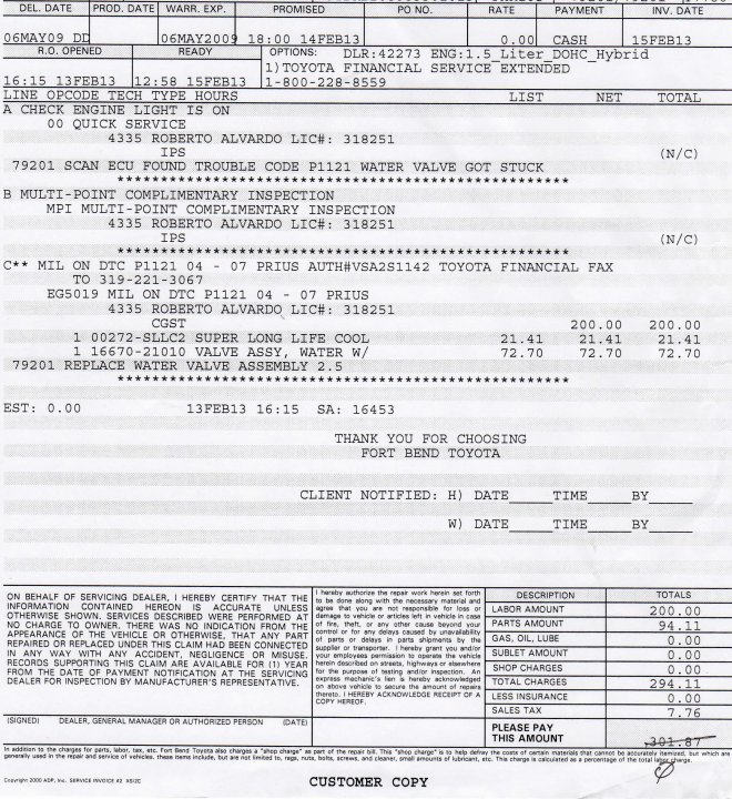

    I got my 2008 Prius in 2009 with 27k miles. Since then, I have it in to the dealer about 4 times to address recall items, the HID headlight issue, and a couple of check engine lights. I change the engine and cabin filters myself as needed and have regular oil changes and the tires rotated and balanced every 6k miles.
    After reading the many posts here, these are the items I think I'm hearing I need to have done now:
    1) clean/adjust rear brakes
    2) drain & refill transaxle fluid
    3) drain & refill both engine and inverter coolant
    4) pcv replacement
    5) replace spark plugs
    I've attached my service invoices for the major stuff that's been done. On some things, the wording is different than what's talked about here. Are there things on my list that have already been done but I don't recognize it because they call it something else?

    Looks like you had the Coolant control valve replaced so they replaced the engine coolant and they also cleaned the throttle body so I would do the Inverter Coolant (easy) and change the trans fluid.
    The Engine coolant lasts forever and see's little wear but the Inverter Coolant takes a beating what with the huge cross section of pure aluminum it has to circulate through.
    Don't bother with the plugs or the pvc. Best part of the Prius is its low maintenance. Only thing the dealer has ever done to my car was the rear brake service as it was very reasonable. $59.99 iirc. Other than that and recalls they haven't done a thing.
