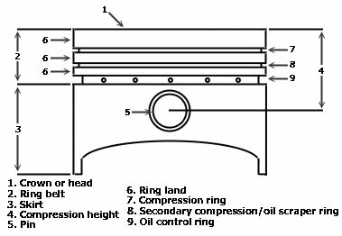

  16. jadziasman
    jadziasman Prius owner emeritus
    Jan 17, 2011
    1,355
    488
    District 6
    Ring groove deposits actually, not ring lands.
  17. sorka
    sorka Active Member
    May 9, 2008
    1,034
    199
    Merced, CA
    2019 Prius
    Yes ring lands. Grooves are between the ring lands and the carbon builds up between the ring and the ring land.
  18. jadziasman
    Jan 17, 2011
    1,355
    488
    District 6
    You apparently don't know what a ring land is. The land is parallel to the cylinder bore wall, the rings and
    ring grooves are perpendicular to the cylinder bore wall.
    Hence the carbon cannot build up between the ring lands and the rings - they are perpendicular to each other.
    Carbon builds up on the lands and often at the ring groove roots.
  19. sorka
    sorka Active Member
    May 9, 2008
    1,034
    199
    Merced, CA
    2019 Prius
    I know exactly what a ring land is:
    The grooves are the spaces between the lands that the rings fit in.
    Oh and if we go by your definition, then the groove is ONLY the bottom of the groove and not the walls of the groove. The grooves and lands share a surface.
    #19 sorka, Jun 13, 2016
    hotelprisoner likes this.
  20. Former Member 68813
    Oct 3, 2010
    3,524
    983
    US
    OK, then you don't know what you are talking about. deposits are in the grooves making the rings stuck and wearing against the bore.
