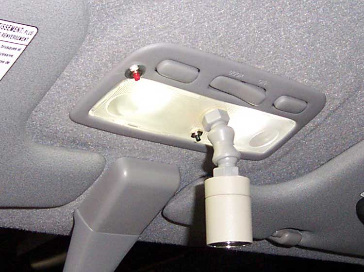

    Piece of cake! Here's what I did in the Rav4EV. All LEDs are independently controllable (you can use the aimable one as your dome light) and they are all dimmable, and will all shut off after 15 minutes no matter how they were turned on.
    More here if you are interested: Articulated LED map light

    All three bulbs in the front fixture are the same. So the front dome is the same as the maps. I should make that more clear for sure!
