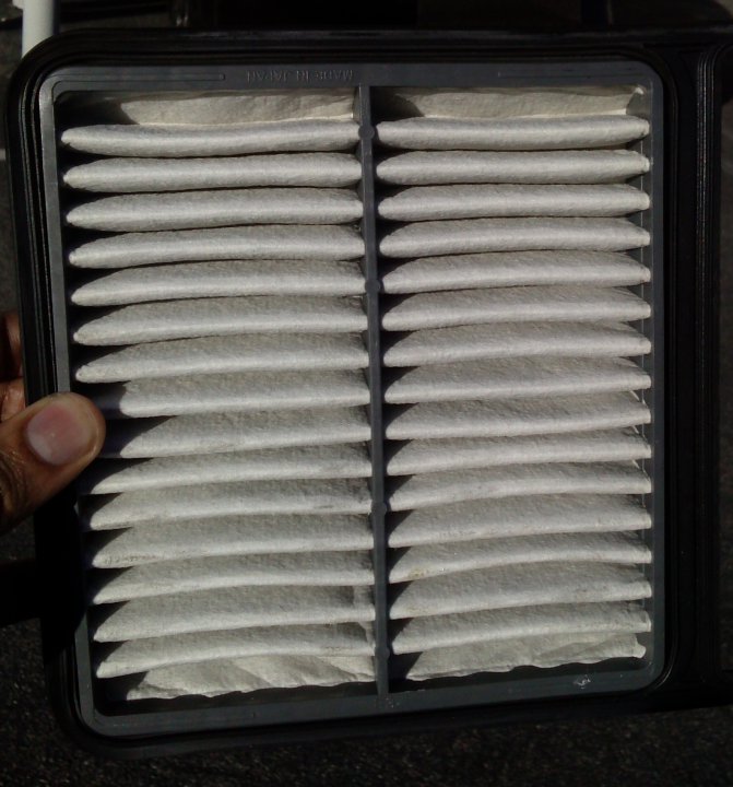

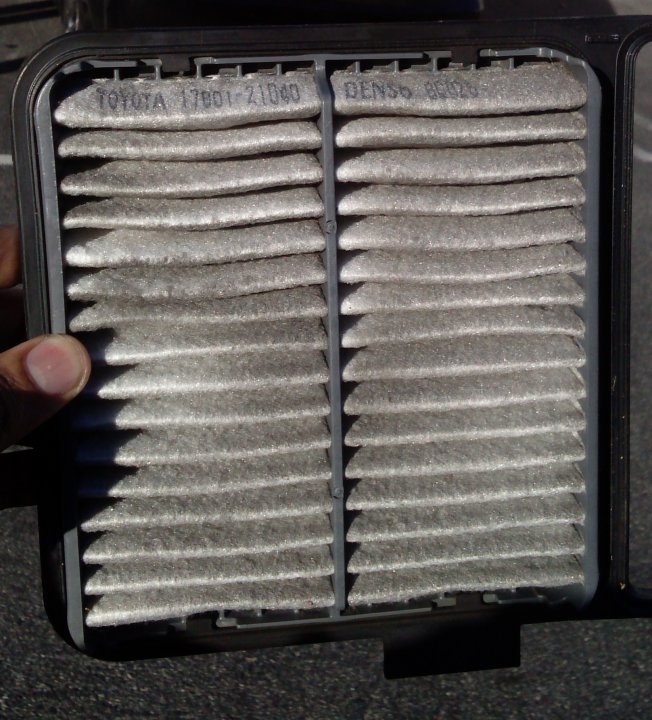

    This is how the filter looks like, unable to have the sunlight pass through, I went ahead and changed it by an new OEM filter for $ 32.

    Any difference in driveability symptoms with a clean air filter?
    If not, I would have the fuel line pressure checked (should be 43 psi or more at idle speed) and if that is good, the injectors themselves should be checked. Good luck getting your issue resolved.

    that is one dirty air filter, when was the last time you change it?

    Would the sunlight show through the new one ? I kind of doubt it.
    I wouldn't give a seconds thought to changing out the filter in the picture, unless maybe the picture doesn't do it justice.
    If the new one didn't really make any difference and you still have that old one, I think you should put it back in and keep the new one for use in another year or so.

    When a new paper air filter is held up to the sun, you will see that the paper is translucent and therefore will be lit up. I am not saying that you will actually see the sun through the filter.
    An excessively dirty paper filter, having trapped dirt in the paper fibers, will be dark. See for yourself.
    This is a reasonable test for owners who do not observe the maintenance schedule which requires replacement of the engine air filter at 30K mile intervals, or who live in areas where the air is unusually dirty and the air filter therefore needs more frequent replacement.

    In post #27, I believe the OP's first photo shows the top-side view of his old filter while the second photo shows the bottom view.
    In any event, when I lived in south Orange County I changed the engine air filter at 15K mile intervals due to the relatively poor air quality. Now that I am located in rural southern AZ the filter looks pretty good even after 30K miles so I use the "light passing through the paper filter" test to decide when to replace it.

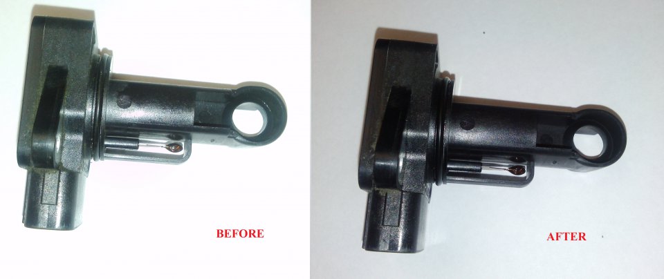

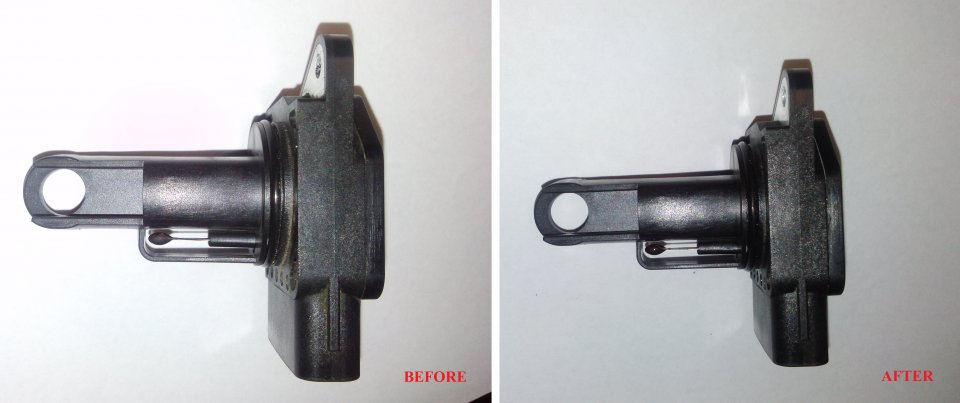

    Los Angeles (SFV)
