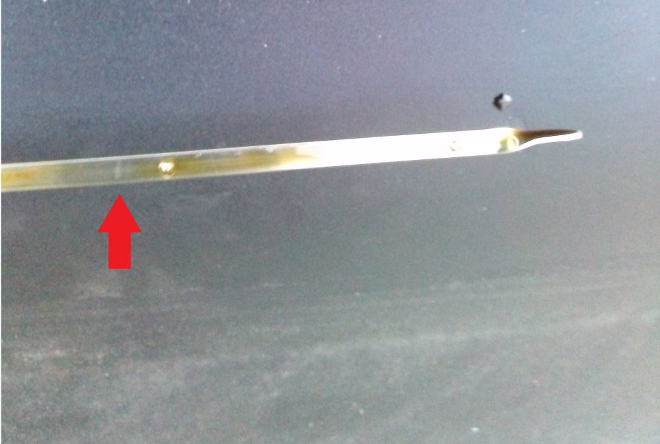

    What's a little over max to you? Dealers have been known to overfill. Too much oil can cause engine trouble. Post a picture of your fill level.
  8. SWprius08

    Here it is.

    That doesn't look too excessive.

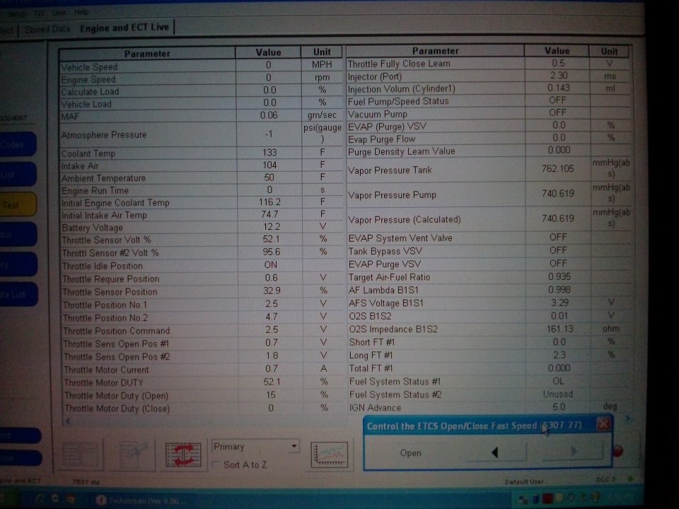

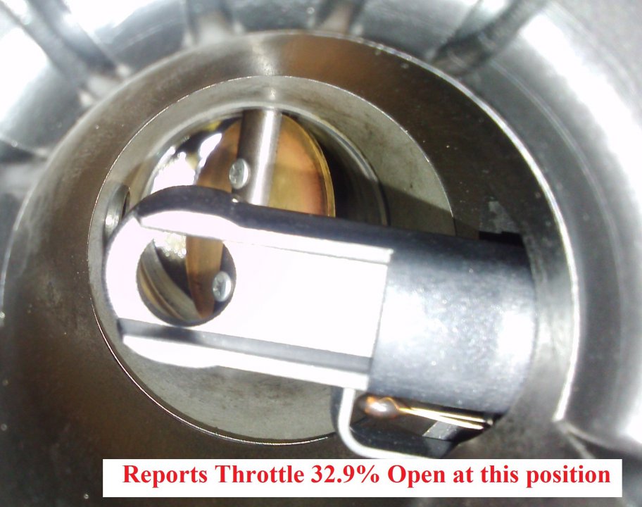

    I have not got a chance to check the throttle position by manually opening the opening the valve fully, however the software had a couple of tests that I can perform where I could open or close the valve fully and then check the readings, when on close the "Throttle Sensor position" shows 0%, however then open it shows 32.9%, not sure if anything can be concluded from this (see attached picture), while doing this test the car was on by pressing the power button 2 times without pressing the brake pedal. However I will try to open it by hand tomorrow morning and then check the reading.

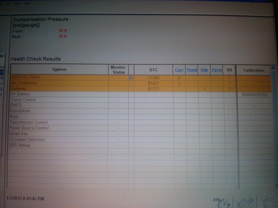

    I had found the below current DTC's on the laptop after connecting the mini vci when I performed a "Health Check", I cleared these and after some time re ran the health check and they did not appear again, it has been couple of days of driving I will check it again today to see if these DTC's re-appear. These have never showed up on my car's screen.
    1) ABS/VSC/TRAC - C1300
    2) Air Conditioner - B1421
    Update: After couple of days the C1300 still did not come up.

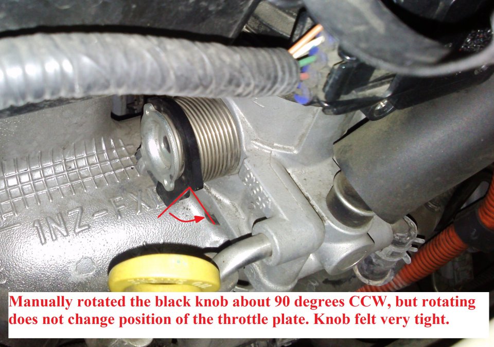

    Based on the instructions of this page Toyota Prius: How to Clean the Throttle Body - PriusDIY.com I tried opening the throttle plate by hand while having a live monitor, however the plate did not move, the black knob felt very tight but I was able to rotate it counter clockwise about 90 degree and held it in place for few seconds but the plate did not move (car was on by pressing on/off switch 2 times without pressing brake), is this normal? See the picture of the knob and upto the position I moved.
    After this I performed the same test again of opening/closing the throttle from the software, it again reported 32.9 % open and at this position the throttle opening looked like this (again car was on by pressing on/off switch 2 times without pressing brake),
    Not sure I did not do something correctly to open the throttle plate by hand.

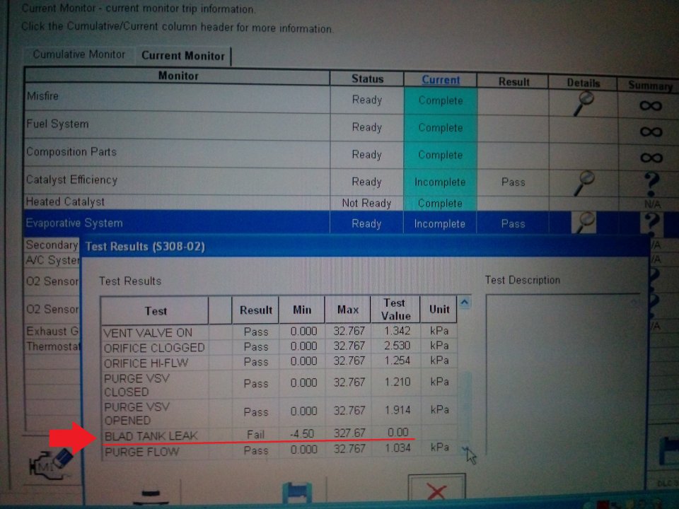

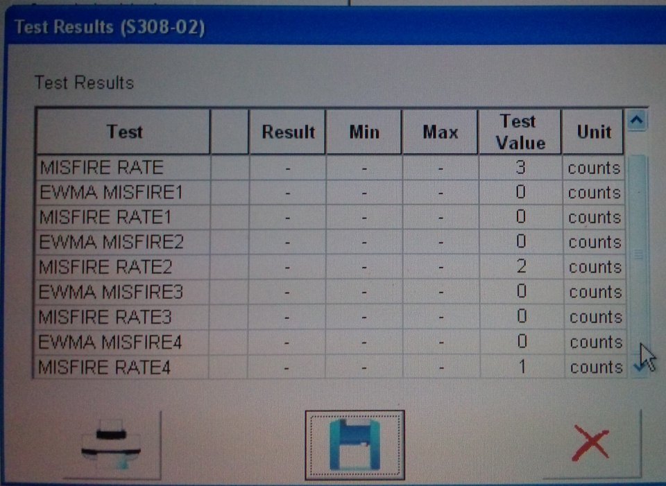

    Apart from manually trying to open the throttle plate I also performed some more tests and I found some interesting results.
    1) When the car is cold the engine hesitates and produces (what sounds like) a misfire. This was recorded in the health check, this did not happen after the engine was warm after sometime when I ran the health check again, it did not hesitate much either (but it did slightly).
    2) Found a "Blad Tank Leak" failing as the test result was 0 under "Evaporative System"

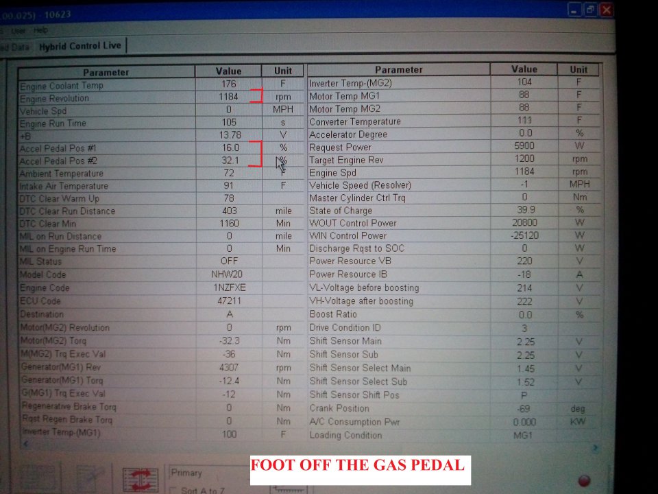

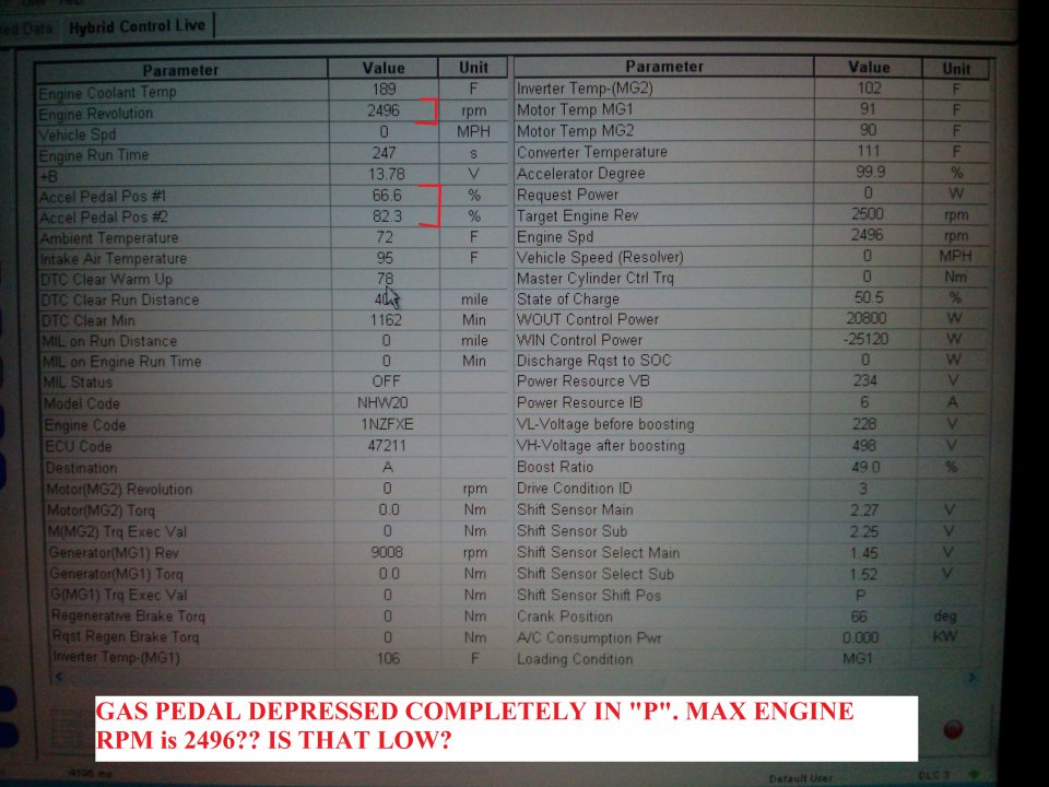

    3) When in parked position if the gas pedal fully depressed the engine only revs till 2500 RPM, is this normal? I find it low? Below are 2 pictures, one of the live screen when the foot is off the gas pedal and another then the gas pedal is depressed completely.
    What can be concluded from these findings?

    Only couple of misfires with cold engine doesn’t seem that bad. Maybe test it again to see if it misfires on those same cylinders. If it does you could change cops (coil on plug) around and see if misfiring cylinder moves. If it doesn’t that indicates spark plug, fuel injector, wiring or mechanical problems.
    I think 2500rpm is normal limit at park.
  20. SWprius08
    SWprius08 SoCalprius
    Jan 26, 2011
    170
    18
    Los Angeles (SFV)
    I have been checking this and found that every time the car is parked for couple hours at the initial startup there will be misfires. How would I know which cylinder is misfiring?
