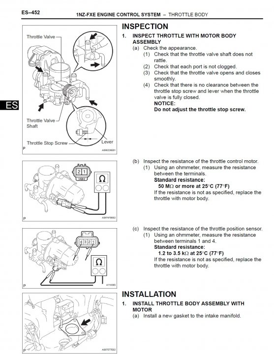

    All Throttle body tests I did were in IG-ON (two pushes on Power button without brake) mode, as the software explicitly said asked to do so for its own open/close test. So yes when I manually turned the knob approx. 90 degrees CCW, it was in IG-ON mode.
    I would love to get a used Throttle body assembly, test it per factory recommendation and replace it with my existing one, however I would just like to know which screen shot are you referring to that shows 16% variance in positions, just so that after I replace I can verify if that changed.
    Here is the screenshot of the inspection procedure.

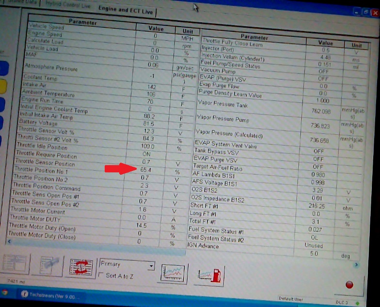

    So finally was able to check the opening by hand today, it did report 65.4% when open full by hand, the valve plate was completely vertical, this was done in IG-ON position, it did not feel tight at all. I discovered that the last time when I had tried to do the same and was unsuccessful, the car as parked for more than 4 hours and hence cold, this time I had already turned on the engine and let it warm, which is why I would think that the car hesitates more when it is cold and then gets better and better. Everything is starting to make sense now. Thank God!

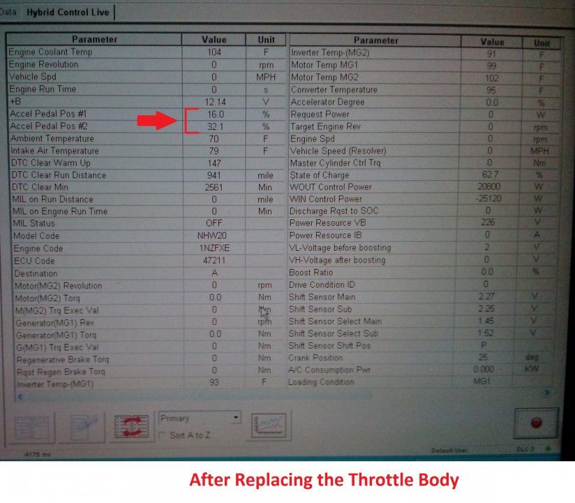

    So here is something we can discuss about the TPS and its variance.
    1) Variance did not change by changing the position of the TPS on the TB.
    2) Variance did not change even by changing the complete TB.
    See screenshots.
    Yakoma, Patrick Wong and PriusGuy32 like this.
  18. Patrick Wong
    Patrick Wong DIY Enthusiast
    Mar 8, 2008
    18,210
    6,517
    Green Valley, AZ
    Thanks for the update, glad to hear your car is back to normal.
    It is also good to have your data regarding the accelerator pedal position sensor readings. For fun, can you please look at that data now that you've taken a test drive, to see if there is any change.
