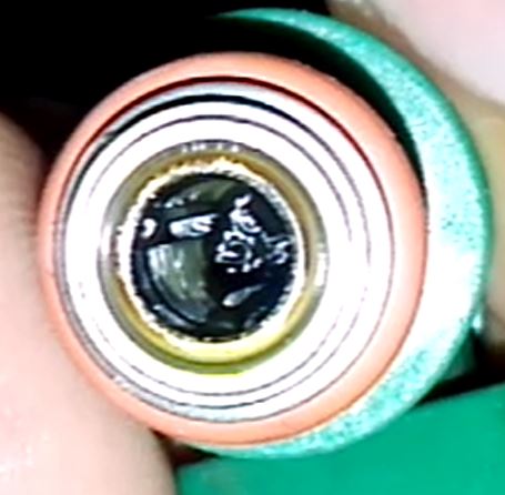

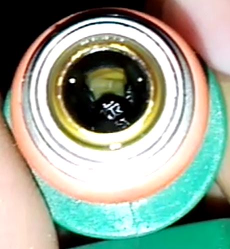

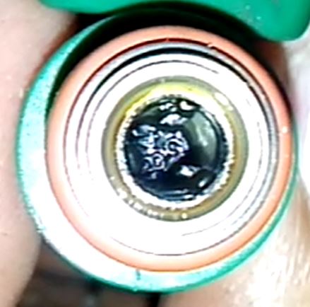

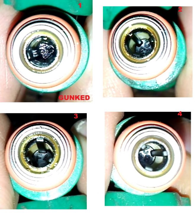

    So since the problem was not completely gone, I went ahead and changed the 4 injectors yesterday and the results are encouraging. The ride is more smooth, less vibrations, better power, lower engine sound. The misfire during cold start up still there. I did find one of the injectors with gunk in it, most likely was the problem and which would get temporarily fixed with injector cleaner in the tank, still have some so will find out when I have the next tank of Chevron with no cleaner. I always used Arco, not sure if Arco did this, but have decided to use Chevron only.
    One unusual thing has started happening, the first time when I replaced the throttle body, this happened a couple of times, upon stopping the car on a light or stop the engine would suddenly rev up high as if the gas pedal got depressed, my foot would be on brakes, I got surprised, since yesterday this is happening almost every time when I slow down to stop. Is the car relearning the pedal movement?
    Here are the pictures of the interior of the injectors.
    Here are some more images of the bad one only.
