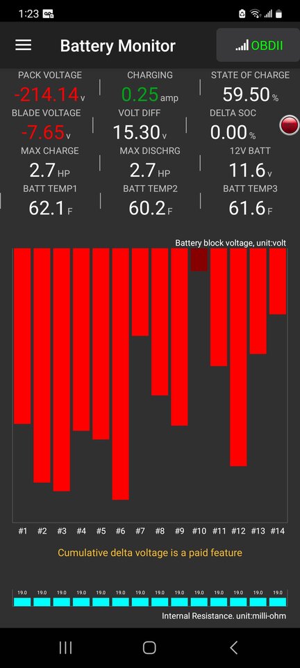

    I changed out a couple of low voltage batteries, every other battery is above 7.6v. The Dr. Prius app is still showing negative voltage. The car starts fine but I still have the red triangle on the dash, no codes on the OBD.

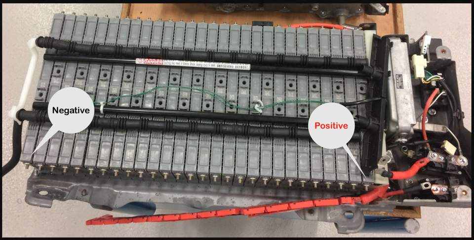

    Did you assemble the battery with the positive and negative terminals oriented correctly?
    Also, visually inspect to ensure that positives and negatives alternate all the way along one side.

    Dr.Prius does not see any errors with the red triangle of death?
    Your adapter may be faulty. There are obvious problems with the battery and modules. There may be a current leak from several or the contacts are mixed up.
