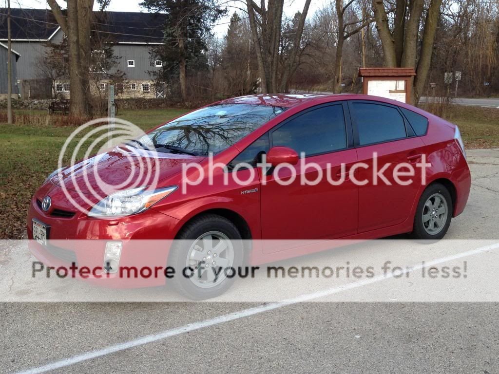

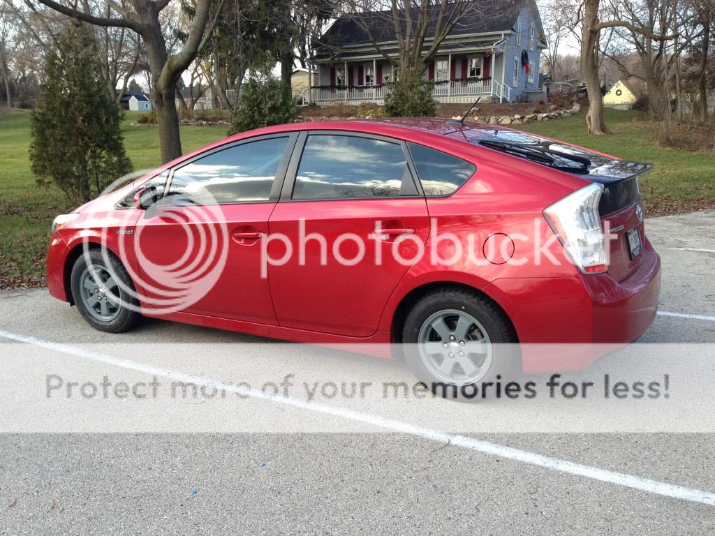

    My work is taking me up to the UP next week so I couldn't procrastinate any longer. I put the gen 2 wheels on the Prius last night. I thought it would look terrible because of the color the previous owner painted the rims, but I actually like how it looks. I like my 17's more of course but this will do for the winter months.
    They're getting 3" up there today/tomorrow, hopefully I'll test these out next week. I paid $380 for the set with brand new Firestone snow tires with the stickers still on, mounted and balanced.

    That looks pretty good... what color are they? Gray?
    I hope they powder coated the rims and didn't just paint them.

    He did, he works for a racing shop and knows what he's doing, they look good.
    He didn't mean for the color to turn out the way it did though, but it doesn't look bad.

    Vas, those are 15-inchers, are they not? I was hoping you had the 16"s. :( But the car looks good!
