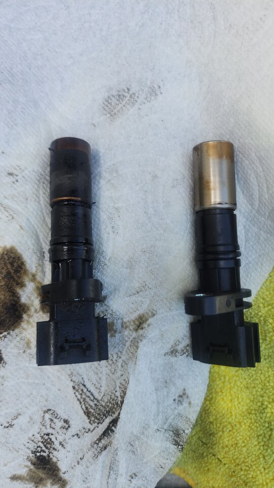

    Additionally, I have attached the photos of the crankshaft position sensor I removed from the car VS the replacement I installed. Is the metal part supposed to turn counter/clock wise with you hand? Or is that suppose to be firm? Both rotate if I turn the metal part with my hand.

    Is that not the vvti valve in the picture that controls the oil going to the cam phaser? I'm not positive of this but that's what it looks like and the PA 090 or whatever that's the problem with the DC to DC converter which charges the 12 volt battery if I'm not mistaken so then when you ready your car right now and nothing started are you seeing the normal 13.5 to 14.5 going to the 12 volt battery? If so then it would seem the DC to DC converter might be working not sure why it's reporting it's not or maybe because of the grinding and the problem in the transmission the DC to DC converter can't function properly not positive of that but you will get the sub code I imagine at some point and see the areas you need to be looking in usually when this happens I just change the inverter because it's a pain in the nice person to get the DC to DC converter out of the bottom of the inverter and they're so plentiful they're almost free but that DC to DC problem maybe because of the grinding business whatever is going on possibly in the transmission. But if it's putting out the right voltage I would say wait till everything is done with the grinding and all that is sorted and see if that just goes away.

    The battery shows proper volts when car is on 13.7-14v but when its on ACC the battery drops a bit. So not likely the dc to dc is bad IMO. As for the sensor pictured, it is indeed the crankshaft position sensor that goes directly on the bottom of the crank pulley.

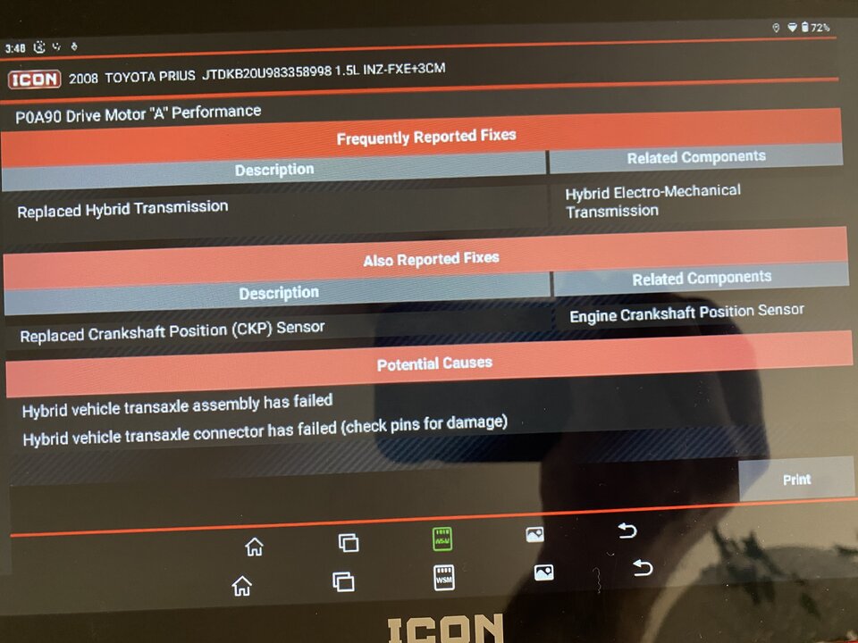

    I was looking for the sub code next to the original PA090 code on the scanner (for example P0A90-XXX) as the manual states would pin point what the root cause of the P0A90 is since it has 9 specific “sub codes”. Not sure if thats the actual name of that but im sure you get the point.
    I agree with you to a certain extent. First, the reason why I mentioned the crankshaft position sensor in the PA090 conversation is becaiuse my scanner suggested it as “also reported fixes”, why? I would have guessed like you as well that it is only Trans related. See photo below.

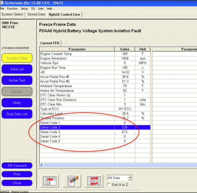

    Those suggestions are crowd-sourced. It's generally not really useful as most people reporting "fixes" are just firing the parts cannon, and if they should get lucky, one of the parts might fix the problem. However, they don't know which one fixed it, so they just mention all the parts they changed.
    You need to find out how you access freeze frame data and look for the Detail Code X fields within.

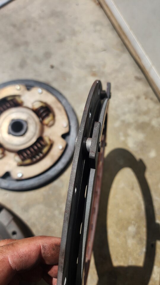

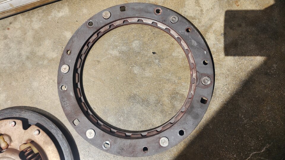

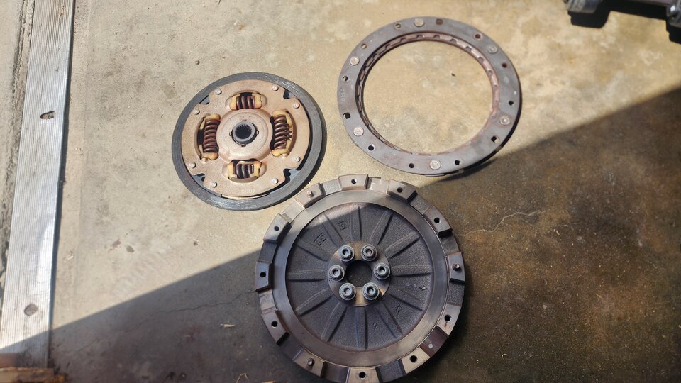

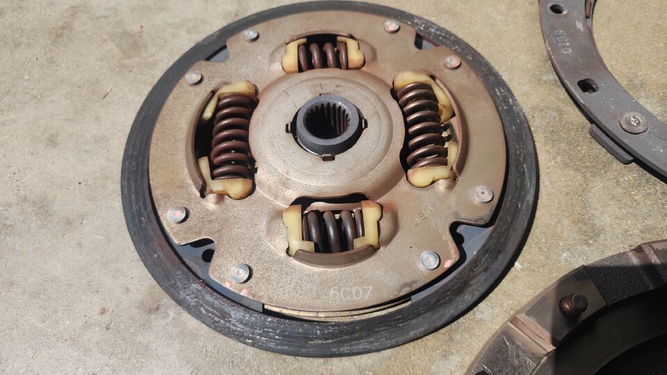

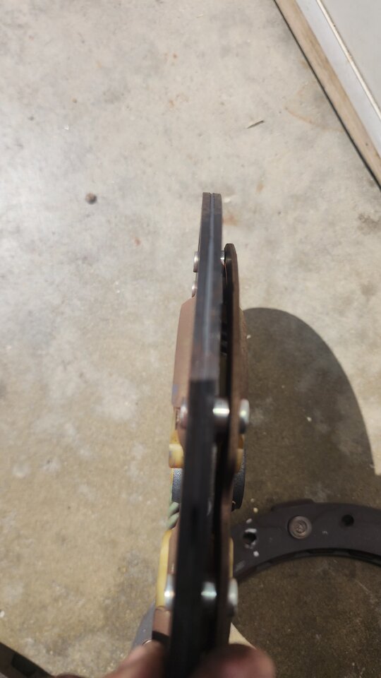

    Here is the damper I got from the Junkyard last week. You all think it still has some life left?
