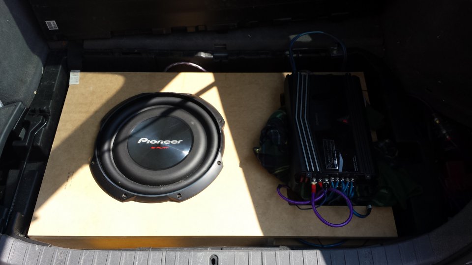

    Great thanks for your help. I actually was looking at the wire harness opposite. There are 2 20 pin harness to the premium radio. I have now hacked the in ceiling mic to hook up to an aftermarket bluetooth. I also hacked the on screen display for the backup camera and reverse sensor. A 12 in a prius is hilarious. Very impressive and I had to turn everything down. Pic of while
