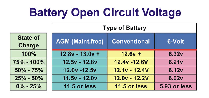

    You will probably find that in the end you will need to buy a new battery, but for now charge the battery up fully with a "smart charger". After that, measure the voltage of the battery with a good volt meter. With NO load on the battery, the voltage of the battery should read a minimum of 12.7 volts after setting over night. If the voltage is lower than 12.7, the battery is getting weak.
    Refer to chart below for more information concerning voltage levels of the Prius Battery. Remember it is a AGM type battery.
    Ron (dorunron)
