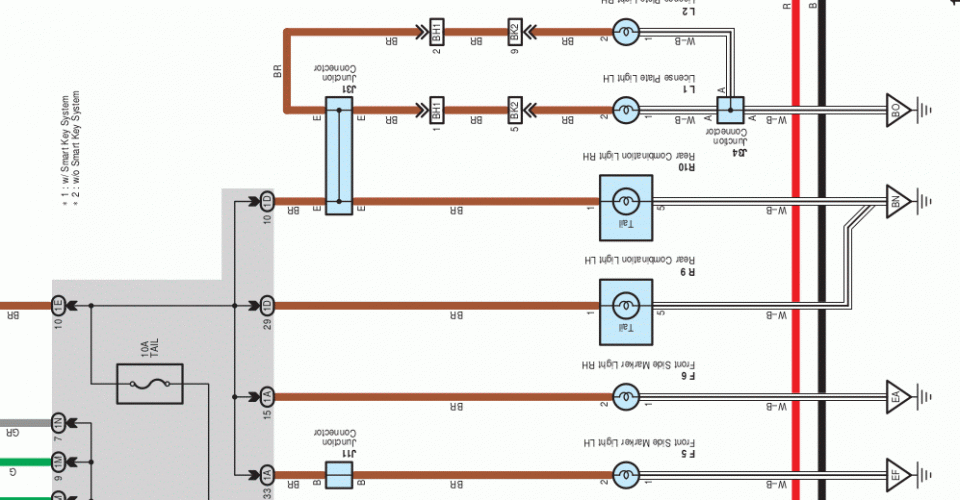

    Here is the schematic for the lights. Very simple. I don't think it is a relay. Somewhere there is corrosion that is causing intermittancy, or else there is abrasion that is causing the wires to ground. The ground labeled BN is what I think is the possible spot. Take all the stuff out of the back and check around under the hatchback sill and latch area. Tighten and clean any chassis ground connections.
