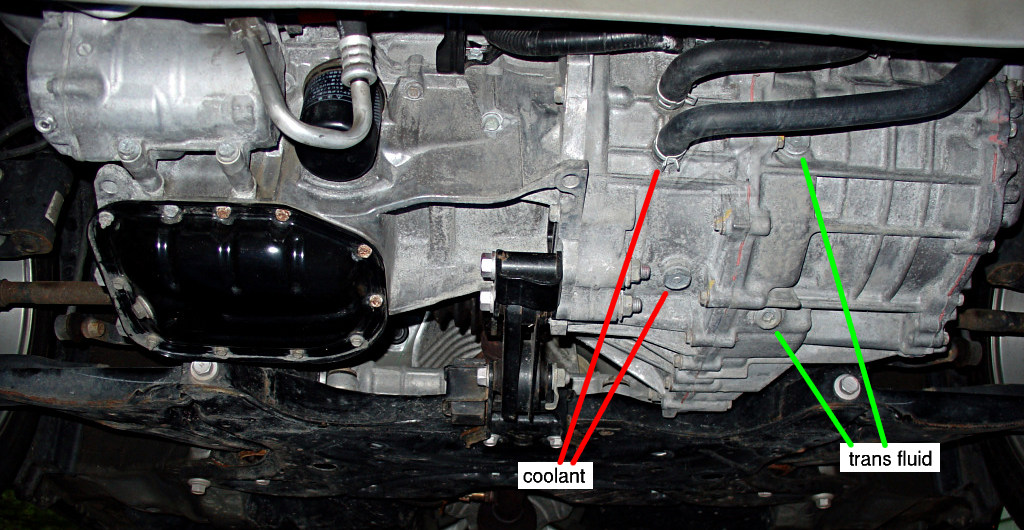

    Jumbo, if you have done the ATF change, I'd like a little instruction. I do most work myself and don't think this would be hard, but is there a drain plug and a fill point? Any other "tips"?

    That is a very helpful picture, but I notice that the linked instructions for the change claim two 10mm Allen sockets for the drain and fill. The fill port on the side requires a 10mm Allen wrench, but the drain port on the bottom requires a 24mm socket and breaker bar. Always open the fill port first before opening the drain, to make sure you can. It's not easy and there is limited space to work. I ended up putting the wrench in position and then kicking it to get it to move.
    Proper torque is 29 foot pounds for both, and don't forget to order new washers.
    I changed both of my Prii's transmission fluids at 60k miles.
    Changing Transaxle oil | PriusChat

    Neo,... a few things, and certainly research this as all I'm doing is passing along info I've read.. I just completed my 1st transaxle ATF fluid change.. it was easy - and written up with pictures on another thread. $85 isn't bad.. I got a quote for $80 from Boulder Hybrid, but I wanted to do it myself. I paid $10 / qt for the fluid, I'm sure the dealer gets it for $5 or less. The summary write up is below. On the Yellow Top battery, I visited Boulder Hybrid, the shop, and there were 8-10, perhaps more, yellow top batteries laying around that had been pulled from Prius cars. It seems they do not work well - according to Paul, the owner. He's now recommending the Toyota battery - and yes, Ouch!! You might want to give Paul a call and talk to him about this; 303-325-7411.
    Here is my summary write up on the ATF change..
    If I ever do this again, I will put the car on the ramps, loosen the drain bolt, take out the fill bolt and place the fill tube in the hole (other end sticking out by the inverter with the funnel attached), then lower the car to flat ground (off the ramps), place the drain bucket under the drain bolt, reach under and unscrew the loosened drain plug (you can reach is easily from under the front), let the fluid drain, put the drain plug back and tighten enough to not let the fluid leak out, fill with 3.5 qts of WS ATF, then drive the car back on the ramps, and finish filling (another .3 quarts) and tightening the bolts. This sequence prevents any movement / starting the car, while there is no ATF fluid in the car. I think I could do the above sequence in about 20 minutes now that I have done it once.
