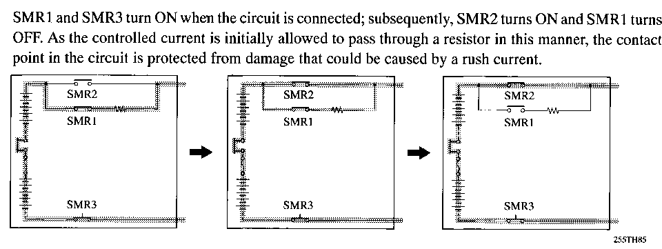

    Of the three contactors, SMR1, SMR2, and SMR3, SMR1 controls the precharge resistor. Precharging begins when you hear SMR1 and SMR3 close together. There is no precharging happening before that.
    The precharge resistor is sized so that once SMR1 and SMR3 close, the capacitors in the inverter take only a tiny split-second to charge. The point is to just slightly blunt the otherwise massive current spike that would happen without precharging. The length of that 'delay' is only such that what you hear from the contactors (SMR1&3 closing, SMR2 closing, SMR1 opening) just sounds like a ragged clickety-click instead of one unison click.
    The delay that you notice before any of that happens is the car's ECUs waking up from sleep (if you weren't already IG ON first), running through pre-READY checks, and agreeing that the car is ok to make READY. If it is, then the HV control ECU goes ahead and activates the three contactors, in the above sequence, verifies the right voltage reaching the inverter, and you're in business.

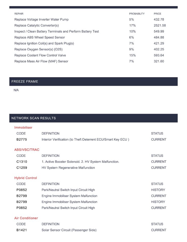

    Update (could be last - running out of time to solve this). Winter's coming and can't keep loaner car forever. Never got Techstream and think if can't be solved without it I will just throw in the towel and have the car junked.
    Got two MPX Power Supply Control ECUs off ebay (same part number as the one in the dead car 89670-47010). Plugged the 1st one that arrived and nothing changed. Plugged the 2nd one when it arrived & was able to get to ACC after pushing power switch once without brake. In this state could not read codes. Pushed power button again and got to IG ON. Now windshield wipers, radio, windows etc worked. And was able to read codes. Eventually pushed power button a third time and it turned off. After that could not get it to go to ACC or IG ON again. It's like something in the system fed the new Power Supply Control ECU some info that told it to not allow the car to start.
    Some of the codes read are understandable since the whole front dash is torn off & the airbags are disconnected. The two codes that I think are clues to the real problem are B2775 & B2799. Interior Verification (to Theft Deterrent ECU/Smart Key ECU ) & Engine Immobiliser System Malfunction. Looks like that could involve a certification ECU & transponder ECU among others. Because I only have a week or two to get this right - any ideas on how to pin point the exact device causing the problem? Codes are attached to this reply.
