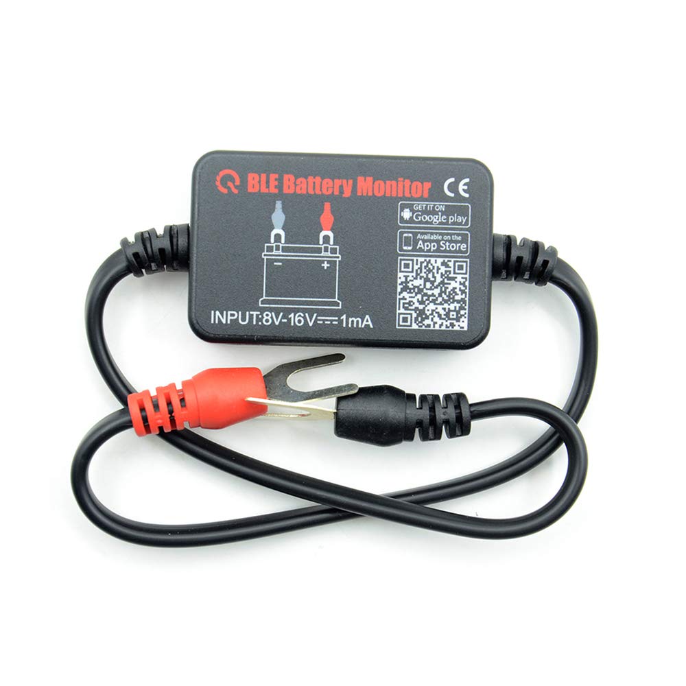

    No problems here, knock on wood, but I've been having fun with a BM-2 battery monitor.
    Cheap. App can do 4 sensors. 1.4mA draw. Can log 30 days on its own. Graphs show volts over time.
