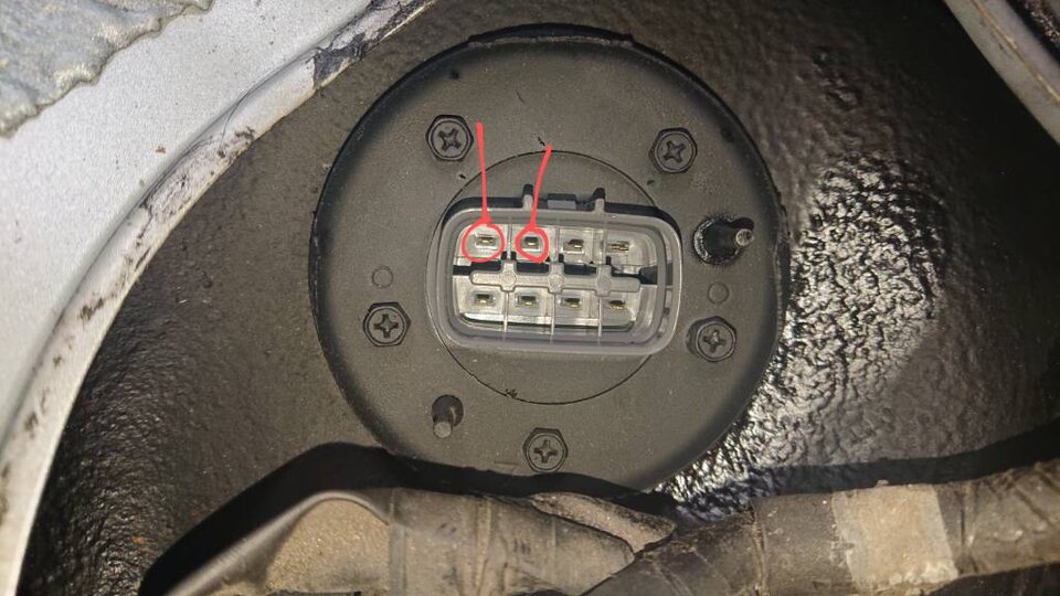

    Most of the Gen 2 fuel tanks that I have replaced were done to correct fuel gauge problems. The level sensor inside gets worn and goes "open circuit" - which the dash gauge shows as 1 flashing bar.
    No, the whole tank assembly is sealed, and I don't know of any (reasonable) way to repair it.
    You can remove the rear seat base and access the fuel tank electrical connector to test sender resistance. It should read around 4 ohms "full" to 110 ohms "empty". If it is much higher (Kilo to Mega ohms), then it's bad.
    I believe it should be these two terminals (a brown and a black wire) prius%20tank%20conn.jpeg
