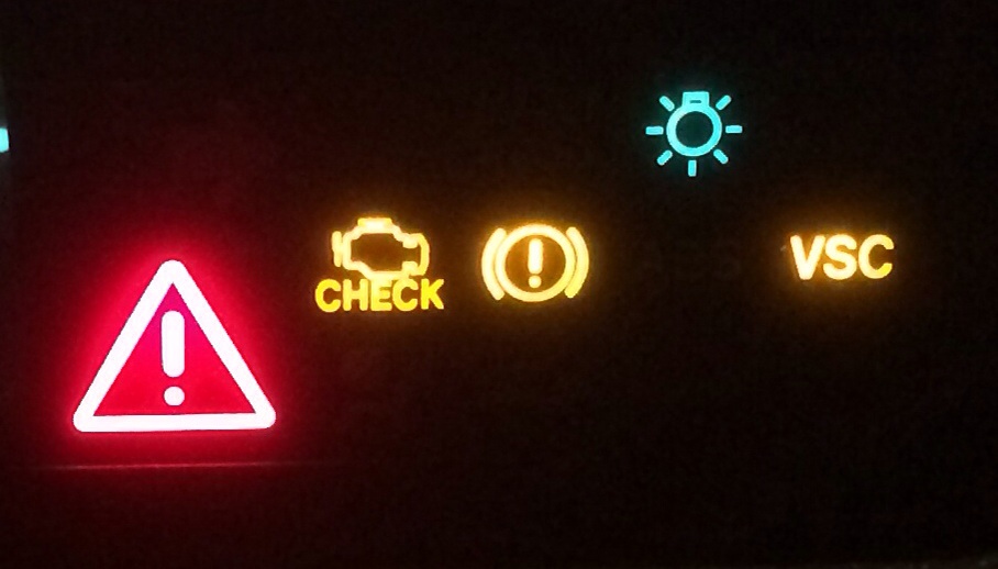

    Last 3 days, I've had these these lights (see image)
    Car seems to drive fine.
    - Big red triangle
    - VCS
    - Brake (yellow)
    - "CHECK"
    At AutoZone the scanner found no codes; no problems ?!

    The only thing those lights tell you is that there are diagnostic trouble codes (DTCs) that need to be read. Until you do that you're flying blind.
    The most important thing you can do is ask that your shop read the codes, document them, and give you a copy of them.
    Armed with those codes, more advice can be given.

    make sure you go to a shop with prius aware scanner, otherwise, they might be flying blind.
    shouldn't cost much for a scan, don't let them do anything costly until you look up the code meanings

    Car in shop; tech showed me voltage on modules(?) 1-5 constantly switching; other banks the voltage was stable.
    Shop will now examine battery and will advise.
    (AutoZone device showed NO codes).
    Possible just some corrosion and he can remove. Otherwise, looking at battery replacement. (age is 16 years).
    Now, I am learning battery 101. Tech will advise, but I need to understand various options he may suggest: new Toyota battery, new 3rd party ?, or find rebuilt battery, etc.

    Private mechanic… he opened old battery, lots of green (corrosion), looks like new Toyota battery with warranty is good, long-term option.
    (1) was water leak, now fixed
    (2) seems prior owner had done some work in battery, Did not coat or seal it completely. Was not on carfax when I purchased, 1 year ago. “Dirty trick” said mechanic.

    Too much nickel had been scrapped away (prior `battery repair` -- before I owned vehicle)
    Had to buy new `service` main battery, which is still Toyota battery but re-uses some of existing electronics: (~ $2900, with labor) 36 month warranty.
    vs. completely replace (~ $3500, with labor), 60 month warranty.
