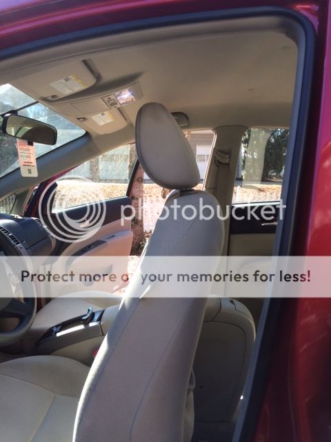

    UPDATE: Went out and took a pic of my daughter's 2008. Sorry to say, Gus, but it appears your seat is broken or bent. Here's a pic taken laterally at 90* to the seats. There is no difference in seat position when they are fully forward in the track and fully un-reclined.

    Thanks Yakoma for the picture. I fiddled with the replaced seat whenever I have time, and at one point it came back to the right position. So I am good in that sense.
