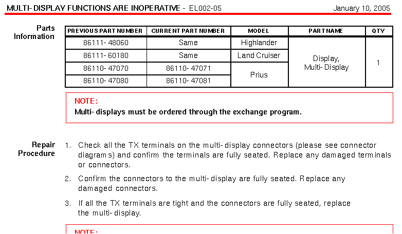

    Is this correct? I have the non-navigation unit.
    Here's a pic from mine.
    From this article I read that it is the same display as the 2004/2005 has. I always thought all displays from 2006 onwards were different?
    So what does this mean for my wish to put in a reverse camera? I have been focussing on post-2006 articles, but it now turns out I have to look at older articles?
