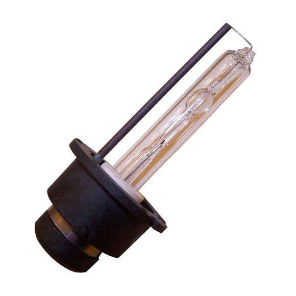

    Easiest way to tell is to look at the lamp from the front. If there is a rod along the side of the tube, it's a HID. See attached photo. I replaced mine at around 60,000 and 120,000 miles. Luscious Garage website has a good video of how to change. I ordered mine online. Just suggest you get a name brand like Phillips or Osram. The blinking off is typical of an HID going bad. It won't get better and cycling the power to get them to come back on will make them worse.

    This winking out of the lamp is typical for an HID lamp going bad and it only makes both lamps get worse. HID recommends 2 minutes off time before turning back on or you shorten the life of the lamp. There is a good set of pictures already for the procedure at the link below so I won't recreate them, but some questionable advice.
    Toyota Prius: How to Replace the Headlight Bulbs (HID and Halogen) - PriusDIY.com
    One thing I disagree with is buying the cheap ebay lamp. He says his expensive Phillips lamp died, but no indication how many hours were on it. There is a thread on this site Not all HID Bulbs are created equal | PriusChat that has a lot of good info and with some manual dexterity and hand strength you can replace both lamps in probably less than an hour, not counting study time. Remember the lamp ECU can generate around 2000 volts, hence High Intensity Discharge, reassemble before turning power on and NEVER turn on power when a lamp is out of the socket to check the other.
