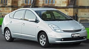

    A second generation Prius looks like this
