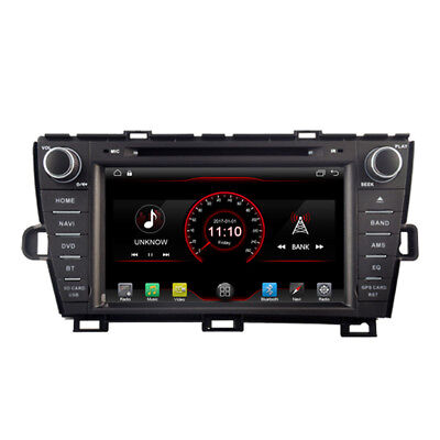

    [​IMG] No. The factory touchscreen units work with the JBL system. Amp under the passenger seat. Different speakers and wiring.
    You should be able to get a Prius specific plug n play. China unit. It will fit in the dash with attached plate. Many sellers will throw in a backup camera
    Picture is an example not a recommendation.
