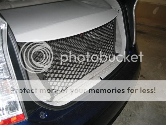

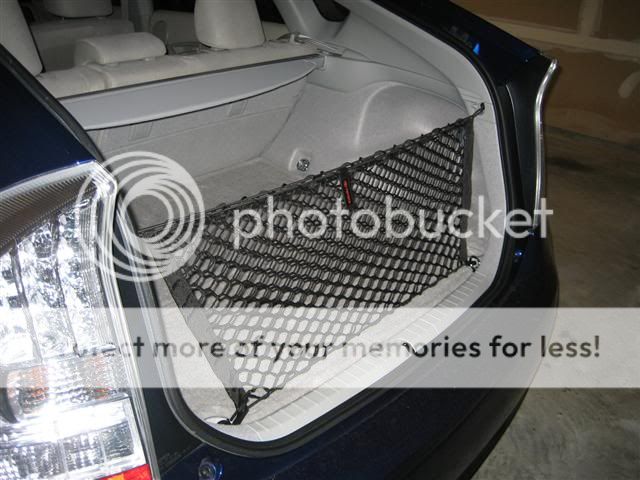

    The OP is the stock attachment system and post #78 is the factory fix.

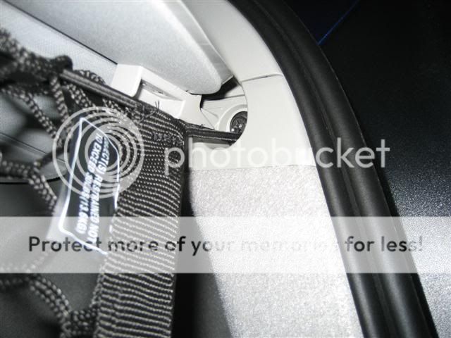

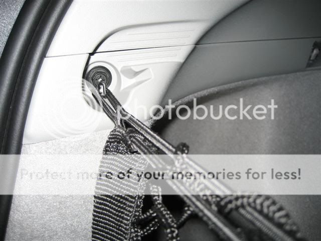

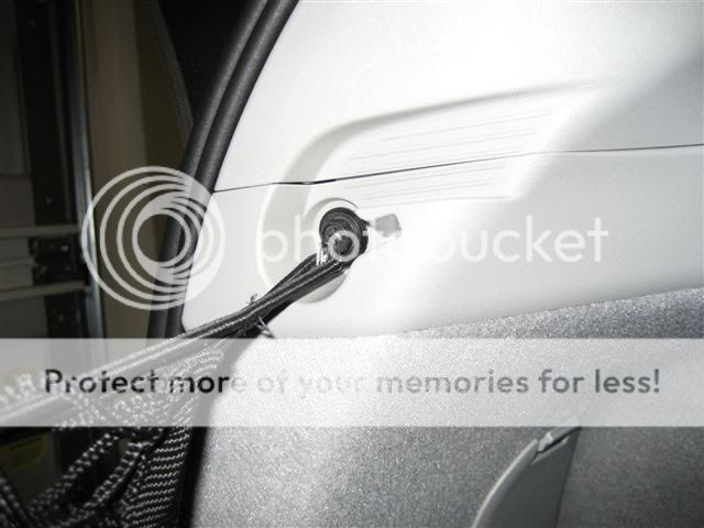

    PT347-47101 is the correct part number for the updated cargo net needed for the 2010 Prius. This part contains, the cargo net with loops on the top fastening points and hardware. All you do is remove one bolt on each side of the hatch opening and install a hook on the bolt; tighten down. No drilling required, just a screw driver! If you received anything other than this, the part was mislabled or prehaps the part number label was removed. In any case, return this to the source for replacement!

    Just thought I would post a quick, easy, CHEAP fix, since the dealer wanted to charge me $22 for the "new" hooks...
    These are actually wall hooks that I bought for $2.57 at Wal-Mart (in the picture hanging/hardware dept.), just some slight bending with a pair of needle nose pliers, and that was it! Works great, and looks almost exactly like the "new style" hooks from Toyota. And it does not interfere with the trunk cover at all!

    I just installed the cargo net into my new Prius III. I was very careful not to over torque the screws, but now the right side screw seems to be stripped as I can turn the screwdriver forever without it getting any tighter. It is tight enough to hold the net, but long term I think I should fix it. Do these screws thread into a part that can be replaced? I don't really want to unscrew it again (risking cross-threading it again) to check.
