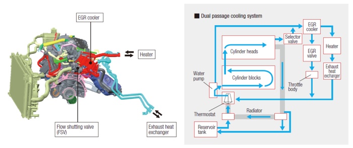

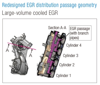

    Thanks for finding that link. I was sure I had seen a photo somewhere of that updated "tournament" routing of the manifold EGR passages, but couldn't lay my hands on it.
    I've been getting lazy with my collection of the New Car Features manual. I have them complete on paper for Gen 1 and Gen 2, and have portions of Gen 3's downloaded but not the whole thing, and haven't gotten around to signing in to look seriously at Gen 4's yet. As far as third-party sources go, that one from marklines looks pretty good.
    The best part? They're a non-US firm, so it explains the Japan/Europe version of the cooling system, with that electric "flow shutting valve" that you can't find in the US parts catalog because we don't get it here.
    I'm not sure what they say about it is quite right—it doesn't square with their own diagram, and it looks to me like the diagram is right—but it's the closest thing to an explanation yet, short of signing in to TIS and reading the NCF. (Certainly "previous Prius models coolant did not flow to the heater during warming" is balderdash.)
    Reminds me of a whole thread over the summer that was filled with guesses about how that system worked because nobody had bothered to look it up, and it took two pages of the thread just to agree on which direction the coolant goes!

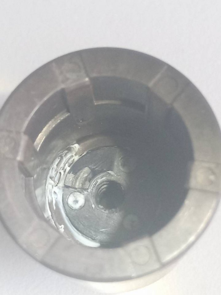

    I see also they added a little stream of coolant that goes right through the EGR valve itself. Probably makes no difference for 99.9% of people, but might prevent the odd freak occurrence like when ozmatt drove hard up a long hill in 40℃ weather and melted a track right through the stop in the plastic rotor.
