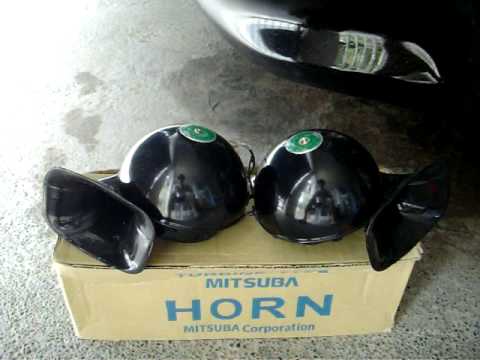

    I'm currently using Mitsuba Air Bullet horns from Japan then I was able to get hold of these...
    it sounds like these
