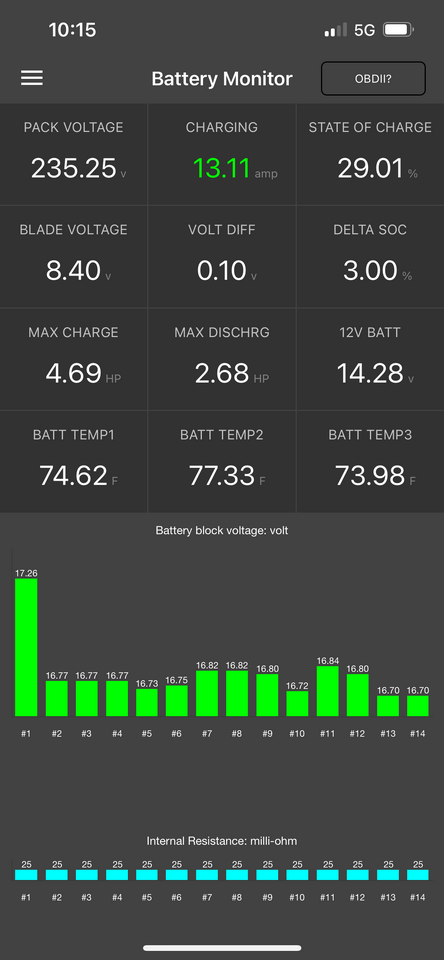

    I am a newbie Prius and got the dreaded Triangle of death and code P0a80. I downloaded Dr. Prius and checked the battery voltages from the app. It was obvious it was block 1 giving the main issue. Attached is the readings directly from the app. Do these voltages mean the blocks are good or are they over charging? I just got this car and since i got it the code has been present. The second module has blown and did not run any other diagnostics on the car. Can I replace modules one and two or do i just need to replace the whole battery? I sent 800 on the car and really don't have the money to just replace the battery without causing a huge strain on finances.

    @valcun18 since you already have the battery out, modules 1 & 2 can be replaced without taking the entire pack apart. This would be the cheapest (at about $35 a piece) way to possibly get you up and running. Make sure you get it from a reputable source (check this forum for a list). I got mine from a random eBay dealer and 2 out of 5 were actually worst than my existing cells.
    Unfortunately, this is just a short term fix as more and modules would fail, and you would eventually need to replace the entire battery. That said, I replaced 3 modules in my 2010 and it’s still running with no errors 2 years later.
    Reconditioning your battery would also help make it last longer, but that can get pricey ($400 and up) unless you know how to make your own.
    I would start with replacing the 2 obviously bad cells. Worth a shot at about $70 and may get you a few months until your finances improve.
